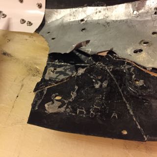

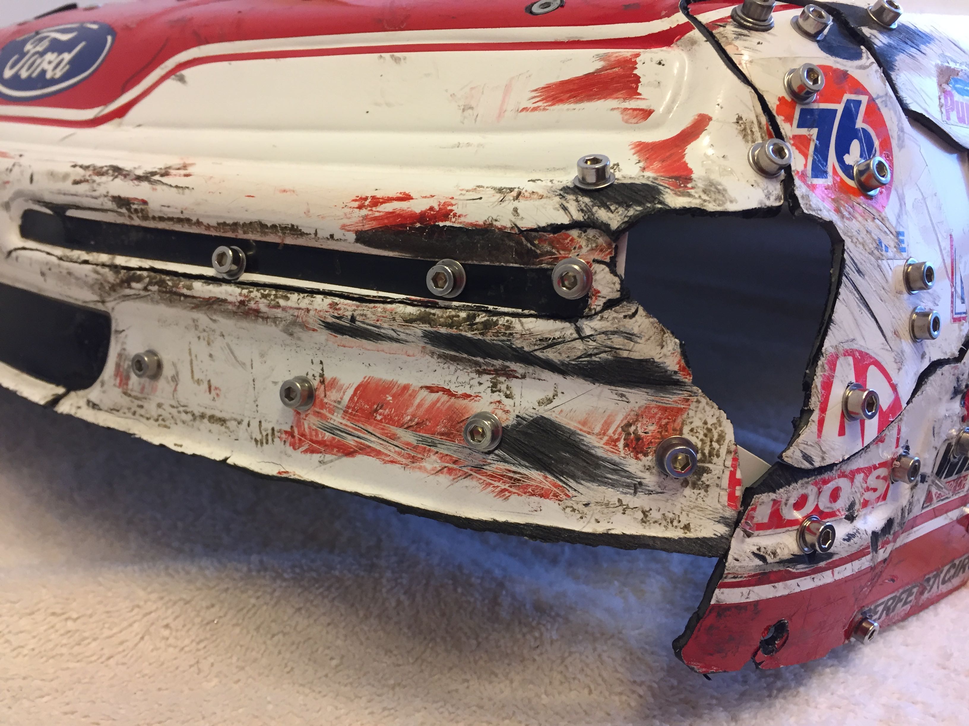

Inside left front fender, removing sheet metal:

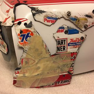

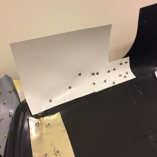

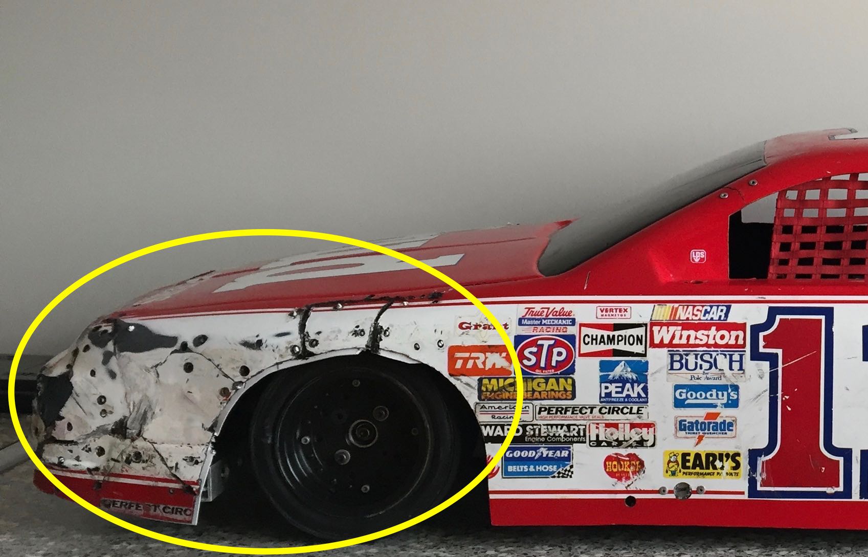

Left front fender, new ABS plastic temporarily attached:

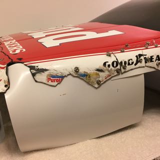

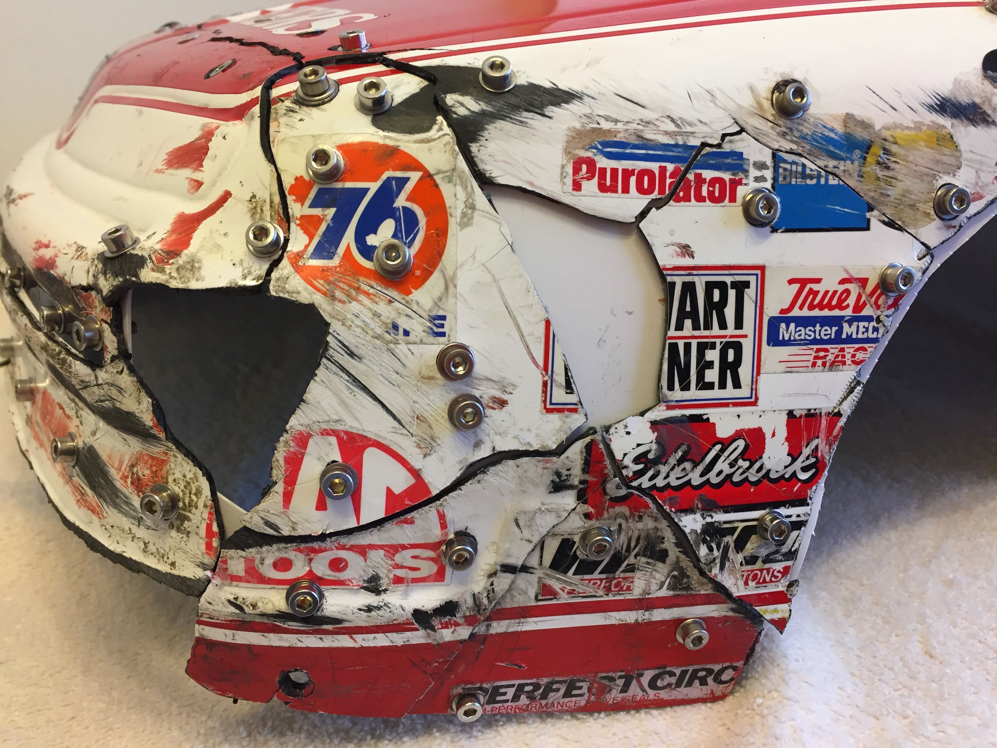

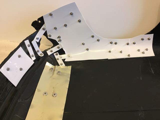

Front left fender restoration in progress showing re-assembled ABS plastic ' fender jigsaw puzzle pieces', fused to ABS plastic backing plates and strips (soldering iron heat source). I'm not skilled at this, I'm making it up as I go along.

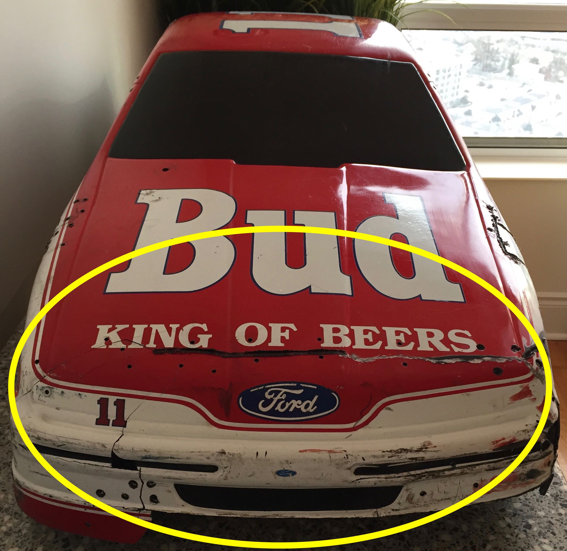

Front end re-attached.
