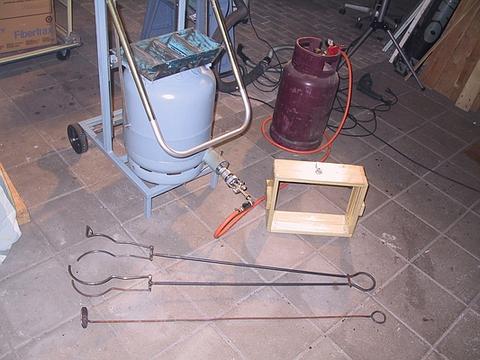

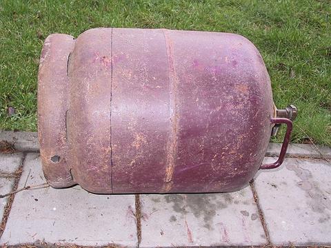

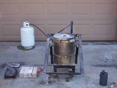

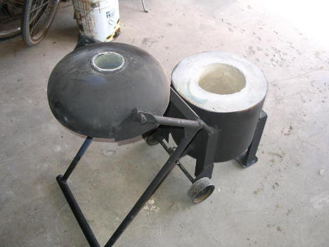

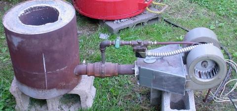

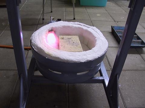

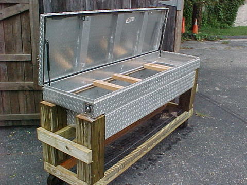

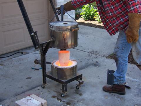

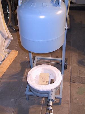

Well guys i've been doing alot of research on various types of casting process and have come to the conclusion that i may attempt to try the green sand casting form...Rather than needing a middle man.. '' Foundry '' I will attempt to build my own foundry... I've seen many types that may work quite well for this application.. I'm not set on what type i may go with yet but i thought i would post a few shots of some home built foundry's..
I'm willing to bet i can purchase all the needed material and build this for around $400.00 I would assume a small water heater would run around $150.00 or so... Or perhaps the propane type set-up??

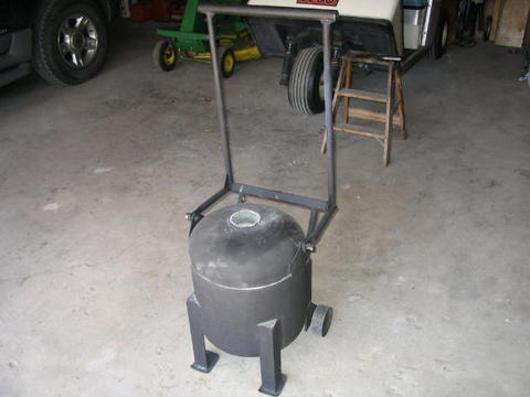

More

you may want to think twice about that. John foster tried this and it sucked. The cost for cast parts really is not that much if you go to a foundry. You would spend less then what you stated on a hand full of them.

Well after a ton of research i have made my mind up on the type of system I'm going to purchase.. It's refereed to as a Cowboy Furnace... It runs by a means of propane.. It runs $380.00 Then i will purchase a Large Steel Crucible that holds up to..15 LBS of aluminum,, @ $65.00 So I'm well within my means of around $500.00 to start... I will then purchase more PetroBond Sand / Parting Dust / Aluminum / Etc... I will build a few flask as well...
I'm going to give this system a shot,, If I'm not happy with the results i will then contact a few foundrys..
I also have a rear end from a lawn boy self-propelled mower i may cast...
