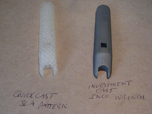

Pictures of an investment cast, specialty wrench I made to solve a production problem we had. I received quotes of six months and 100K from the name-brand tooling manufacturers. When you only need a half-dozen parts, this method works pretty well.
I made a CAD model of the assembled parts and wrench in AUTOCAD; added a positive scale factor to the model of the wrench as cast INCONNEL shrinks when cooled; wrote out an .STL file; ported it over to the SLA machine; printed out a dozen quick cast patterns; brought them to the casting supplier; and in a week, I had my wrenches.

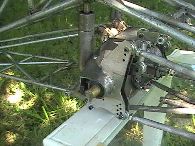

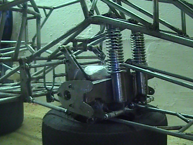

I'll have to look into this... i run SolidWorks Premium from time to time..As for the rear end... There is no center section in my design... It's a sheet metal housing and the third member... Here are a few shots if it in case you haven't seen it....It's not finished in any of these shots but it kinda gives you an idea on what it looks like..
I would like to make castings of it because i may eventually sell them...I don't have alot of free time these days so machining them is pretty much out of the question... Weight is a huge factor here... As it is now my rear end weighs around 10 lbs... Although it is nearly done i do still need to finish up all the required welding... I'm thinking it will weigh around 12 lbs once done... I'm willing to bet a complete aluminum casting would weigh around 2 lbs top's...

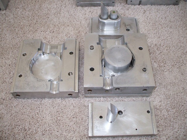

c103110, that is awesome about the one off stuff like that without the molds. Thanks for telling us about it. I asked my foundry about it and they said they can do those, but one part costs about $200!!! Still, wicked cool.
Here is a picture of the skellenger investment cast tooling. Its a bit complicated when you really look at it. Tons of work here.

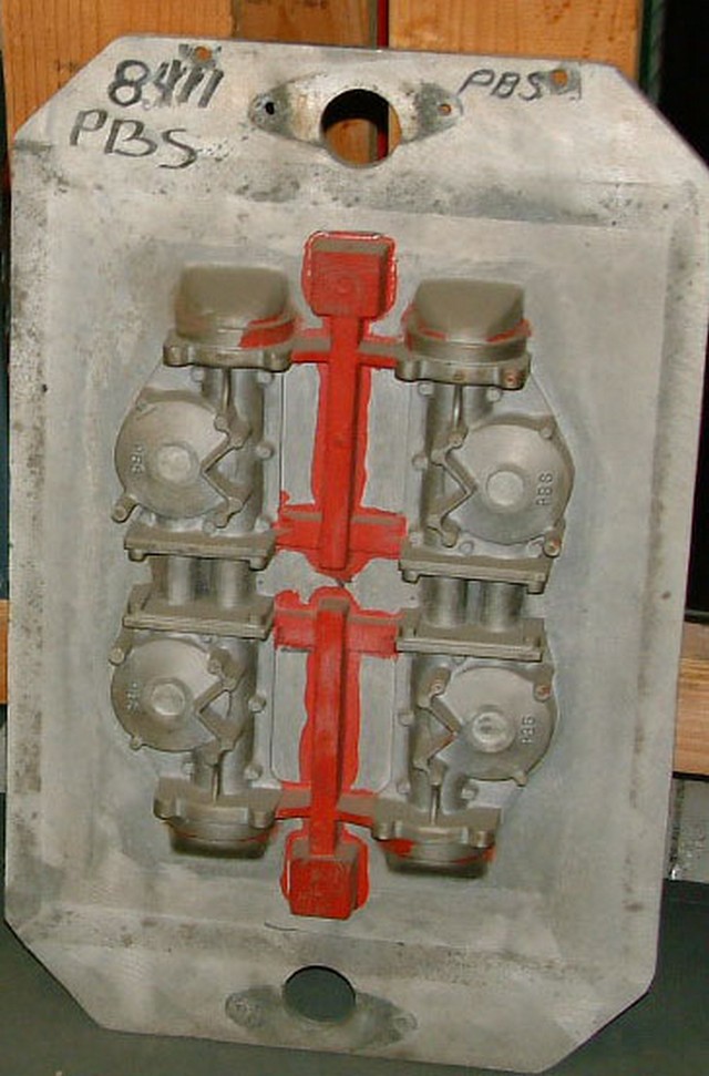

Now, here is a sand cast patern. This is the PBS rear. Very basic and sand casting is quite crude.
