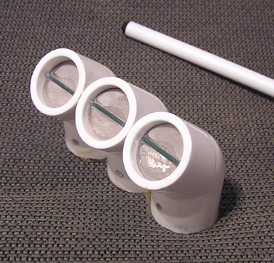

One other option... three 1" PVC 45-degree angles plumbing elbows. glued together like this.
This is what I have on my modern FC.
Actually, I sent this to a Vacuum-molder and had him suck Lexan over it. It was tough to "get out" of the plastic, but it made a nice, one-piece super-lightweight scoop.

A right nice job of it, too... that modern "buzzard" injector is not an easy shape to reproduce. as is the REST of that engine!
