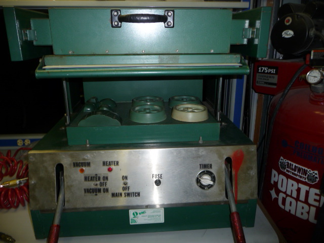

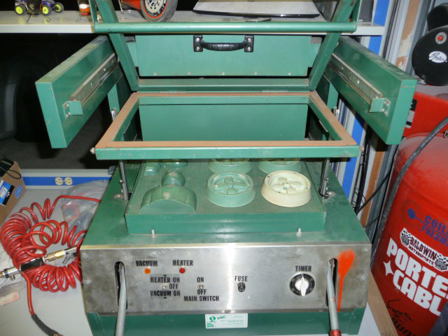

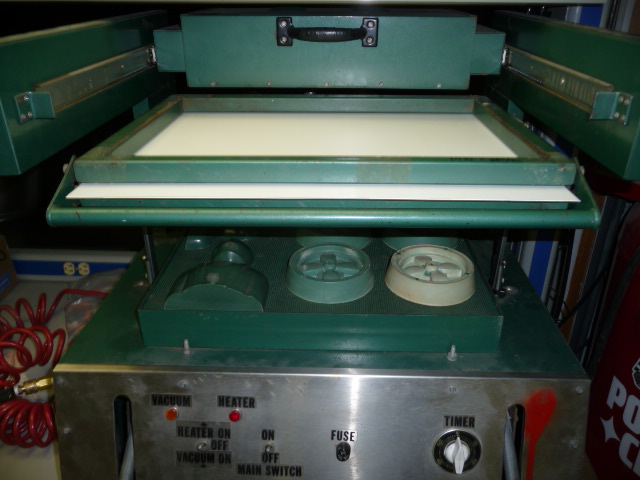

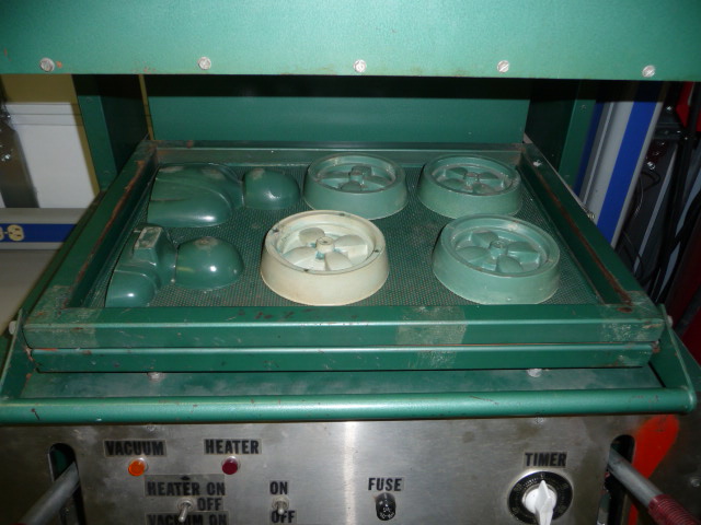

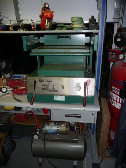

So, i have been looking for months for a decent vacuum forming to use at home. Saturday was finally my day. Professional grade with a 14 x 20" forming area. perfect for Windshields, lenses, wheel covers, driver figures, etc. It also came with a bunch of material to do blister packs to give my lru items that pro look!!!!

It's absolutely necessary to have access to a vacuum forming machine to do production compound-curved clear windows, like on your GTP body, and helpful to make other lightweight small details.
Great that you have found one of these!

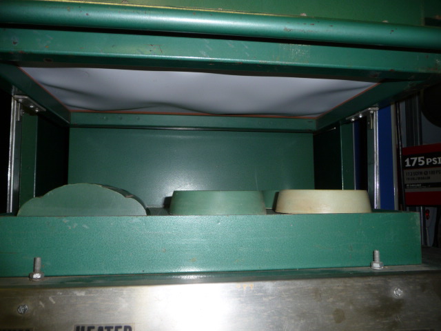

Yea, tried some lexan. When it starts to sag and get close to the right temp. it bubbles or looks like white fog and it destroys it. If i try to form before that, its just too hard. I was going to try the petg i figured for windows and lense covers it would be OK. What do you think? You dont need to dry that stuff first right? ABS is no problem, this thing works great with that...
Re: vacuum form? Ohhh yea!!!
I don't know about the fogging, but the bubbles definitely sounds like moisture in the lexan. Ask your plastic supplier about this, or call somebody at ProLine in Beaumont and ask them.
You might get away with the PETG for clear windows... i do not know if it's also hygroscopic, but it is a polycarbonate like lexan, so it may have the same tendencies. But DO NOT PAINT it!

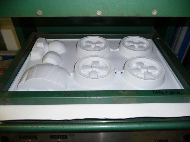

Soooo, today i had a couple minutes to go and score some material. I purchased 8x4 sheets of poly styrene, Petg and lexan. Lexan is the only one that needs to be pre dried before use. The rest of the stuff can be thrown right in and used. Today I tried the poly styrene and it worked very well. I was impressed. Next will be the petg...

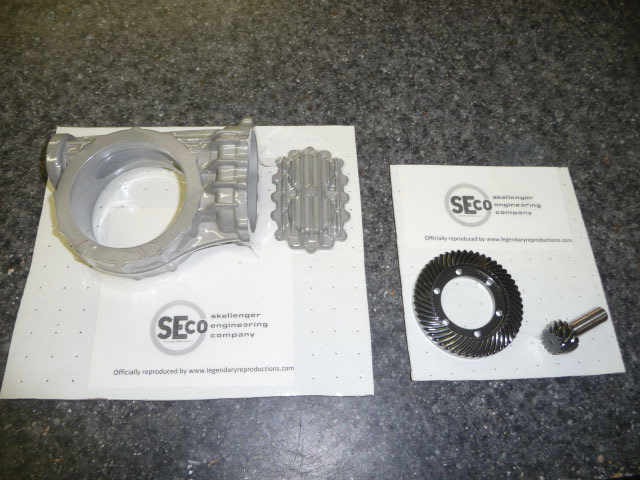

Nice work Mike... I noticed the SKELLENGER rear ends in the shot... I'm in need of one for the COBRA build... If you have a spare you can realocate i would be more then happy to buy....
i dont have an extra one to sell yet. But may need to in the near future... hope not though.

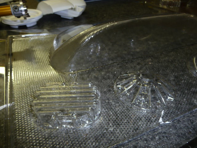

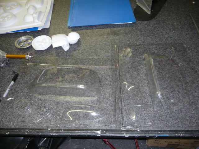

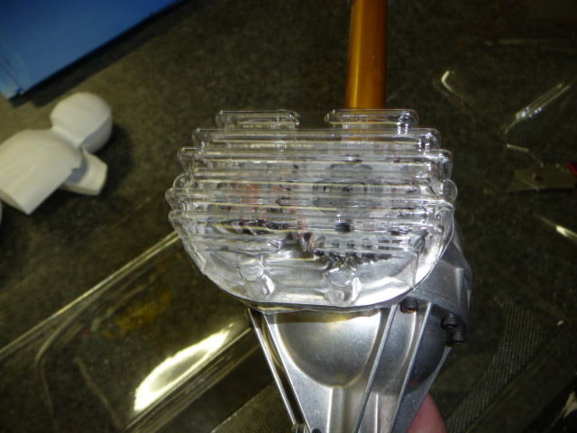

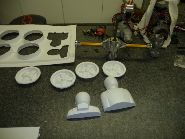

ran some PETG tonight and dang, this stuff forms awesome!!! This stuff came out awesome!!!
I did daytona coupe windshields, front lense covers with side scoops, rear skellenger covers and a skellenger side cover.

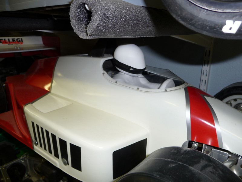

heck yea it does!!! I had some space open on the table so i figured what the heck! I trimmed out a windshield and its much better then the one that came on my daytona!!! This material is good. Much better then the poly styrene I think. Cant wait to try the lexan. Its gonna be a week or so though. Dont have any time...

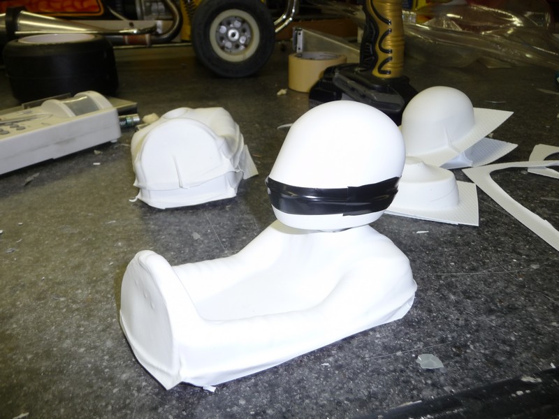

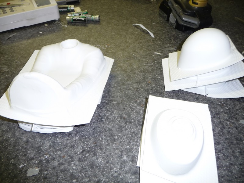

somehow between the 30 things i got going on right now, i was able to start on a mold. Its the driver from the yankee cars. Pretty easy mold to make with some secret juice i had. I did some test pulls tonight and finally got a good pull. I had to get the temp of the plastic just right. Now I know what i am doing... The last one came out really good considering the molds are not done. I need to clean them up and put them on risers still. Gotta love this machine!!!!!!
