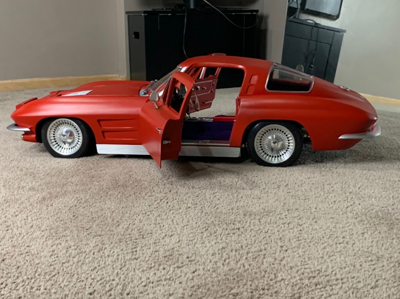

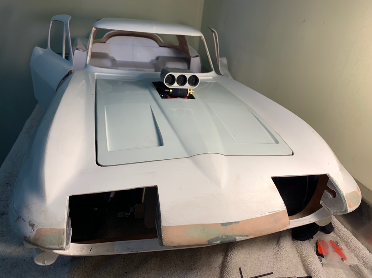

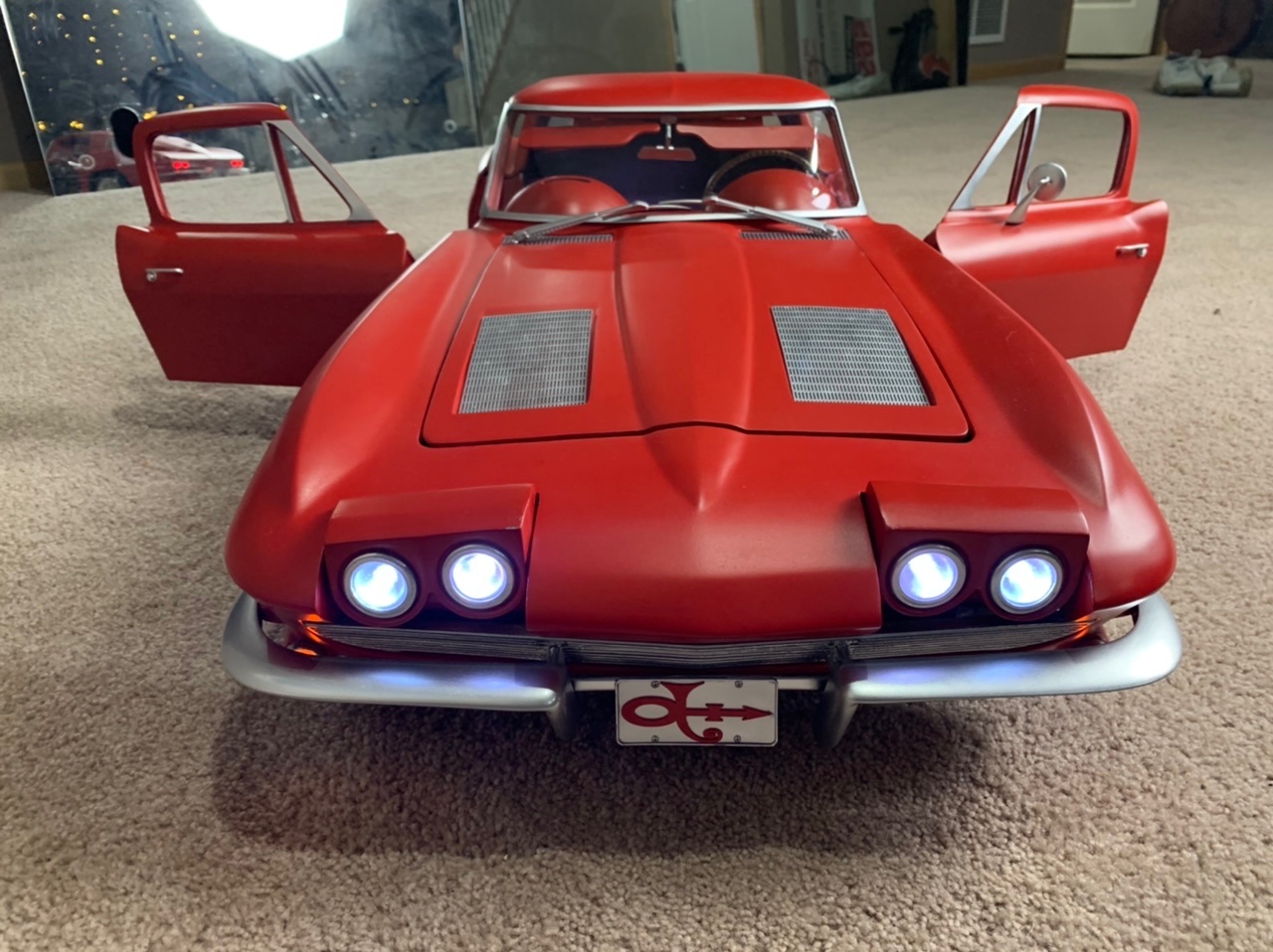

I’ve been working on this project for a while. Fully functional (radio: bluetooth speaker, ignition switch, glove box, etc) in a lot of ways. Planning on posting more about it as the cars progress.

I love it
Re: C2
Fabulous!
Could be a full size C3 photographed in a giant house!

Big what are we looking at here? What kind of kit is this and the size? This is Amazing :o

Emilio,
It is one in a collection of highly detailed, quarter scale C2 radio controlled models. The cars have taken a little over 5 years to build. That was after the 5 years it took to get the owner of the body to agree to sell it to me. I will be posting pics documenting this particular model's build soon. The models were constructed in sets consisting of a chassis, hand laid fiberglass body and mated floor pan (each body's thickness is a little different hence each floor pan must be trimmed to match). Each car has over 300 bolts and screws, 200 plus custom milled parts, 180 printed parts, two wiring harnesses, 100 plus off the shelf parts and a good bit of 3M automotive epoxy. They sport both Conley (327 or 427) and cloned Conley 327 engines.
The functionality includes:

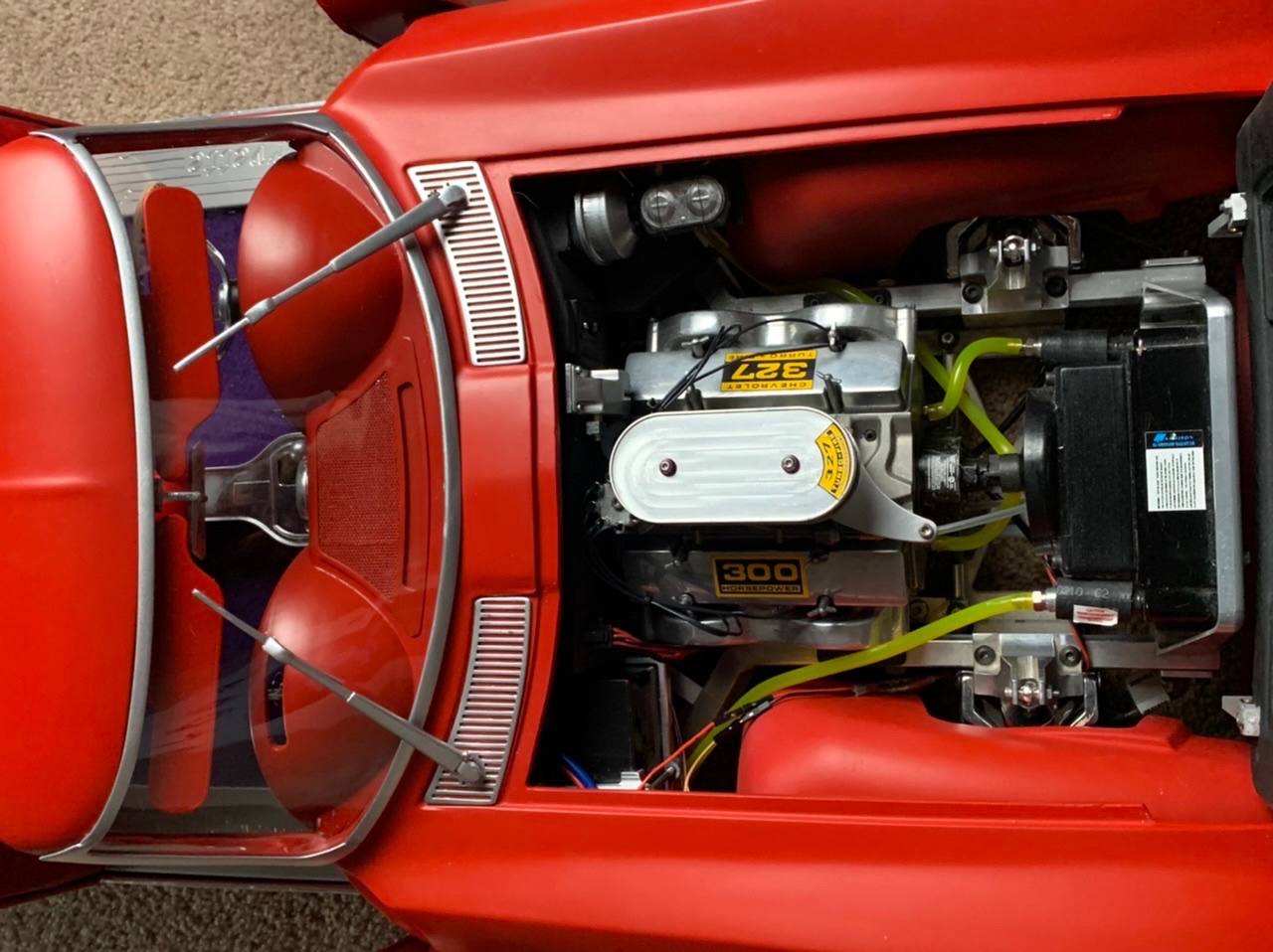

Re: C2

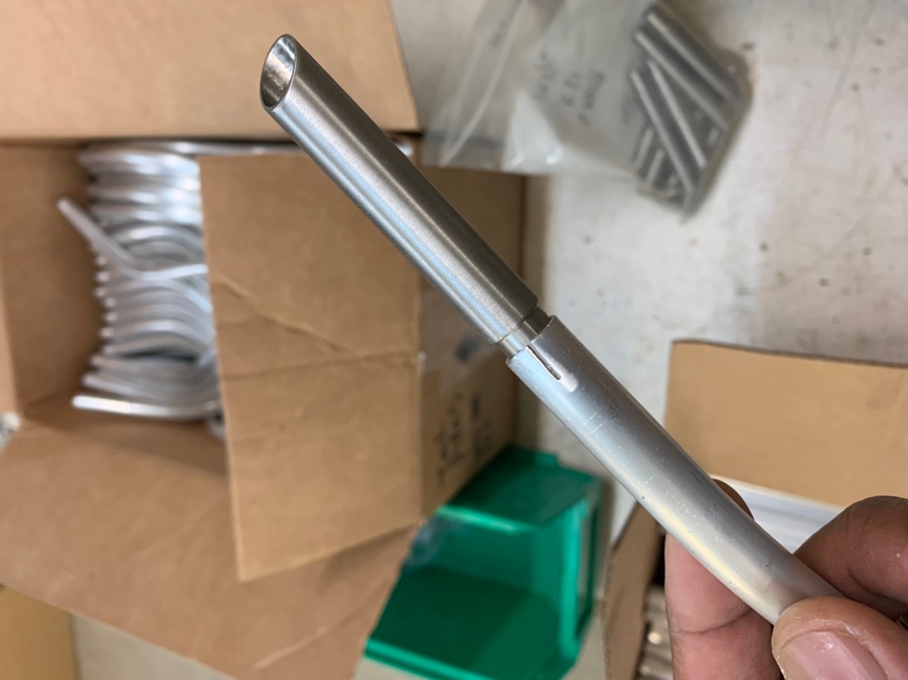

Wow just wow. Will the exhaust actually pass through the cross members? Absoluty scale looking chassis and body, congrats on this one of kind.

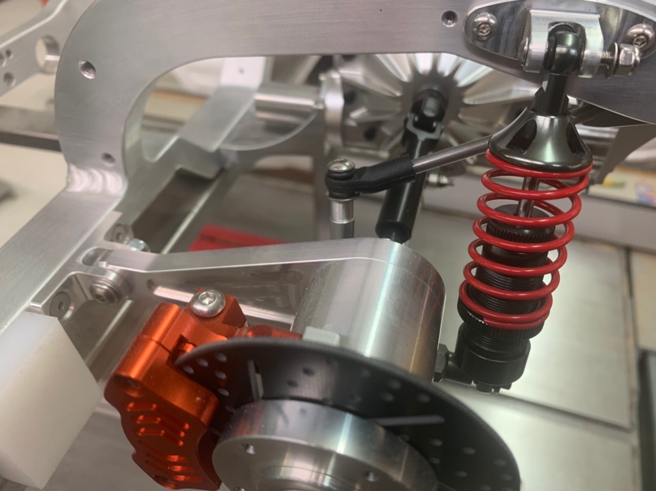

... this was before several edits like the removable steel exhaust tips, compression Y and T fitting for the brake lines,

... The exhaust does go through the cross member.
