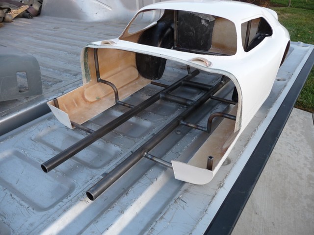

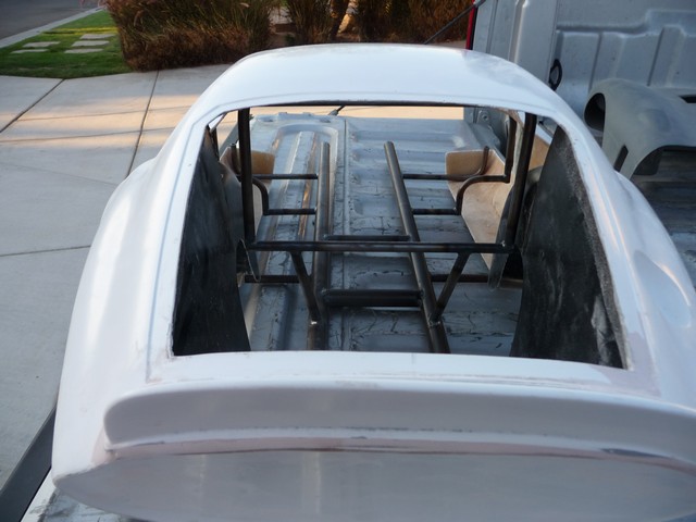

Here at LRU we have been very busy the past few months developing and redesigning the QRS Coupe. Things are starting to come together and here are some sneak peeks of what is comming!

One is sold. A second one is being built at the same time to be used as a company sample. There are a lot of changes done to the engine setup. My car was never built to the point where it could be driven either so there has been a few challenges in that department too. Stuff is starting to come in so I will start posting pics of progress. Just did not do it before because there was not much to show.
Re: QRS coupe 2.0
Also, this frame is only 70% complete. The car has a complex front and rear bulkhead that is laser cut and formed. We are still waiting on those parts to be ready.

This body is the one piece body that has been modified to multipiece with additional scoops and interior. I dont think a one piece would fit right on this chassis because the front is where the hood hinge goes... not yet shown in the pics because its not welded on.
We may sell just a frame if someone wanted it. Might not fit your needs just right though.
Our plan is to produce 2 different models of cars right now. The plan is to see what is involved and the cost. These cars will not be cheap though. The best I can figure is that they will be in the 5-7k range each if we do end up producing them for sale.

The rear is setup for a skellenger modified for independent suspension and the front can use skellenger spindles. But both front and rear is a leaf spring suspension. The braking is going to be done by using quartermortar hydraulic brakes on all four wheels.
