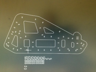

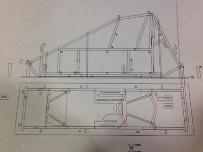

Here is the CAD drawing of the side welding fixture. Looks busy but everything has a purpose and will make for a precision welding jig. I spend the time up front in making very nice jigs and fixtures so i can produce a chassis that is perfect one after another. This design has taken roughly 3 weeks to get it to a point that i can start producing parts on the machine. I just purchased a laser cutting machine around a month ago to cut all the flat parts for the chassis so decided to produce all my jigs and fixtures with it. The small pieces at the bottom of the print shows the locating slugs used to locate all the pieces of tubing in the chassis. The design will be up loaded into the machine and will nest the parts on a sheet of material and cut the design out.

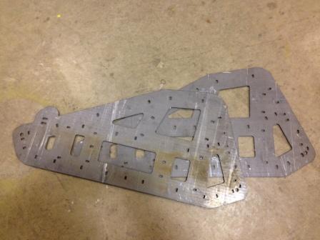

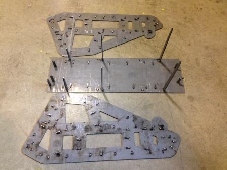

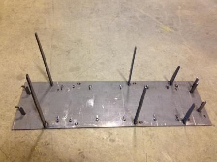

Got the welding jigs cut out and assembled for the new sprint car design. This seemed to take forever to get completed but with precision jigs = consistant products. I needed new jigs for production so the new sprint car design was a perfect time to do so. Hope you enjoy...

Some more pictures of jigs

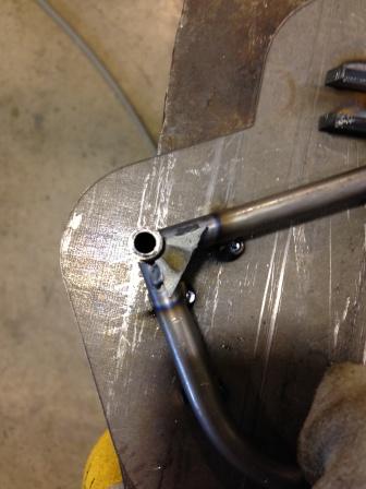

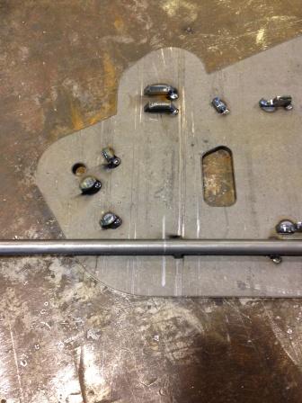

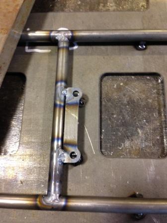

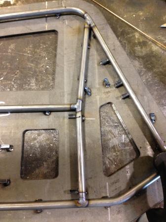

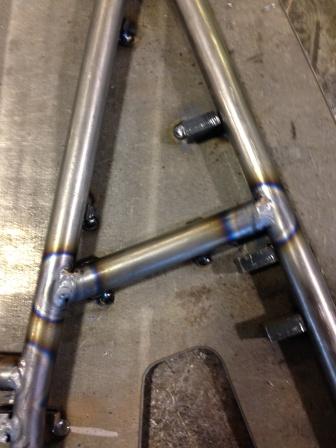

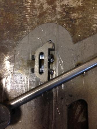

Chassis is moving along.... This is the left side of the sprint car...
Front shock mount located but not tacked in
Rear shock mount
Rear shock mount
rear shock and frame brace
Top loop fabricated and now installed the rear vertical support

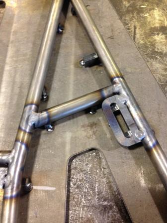

Tie end gusset at front and rear. This little bracket is very important because it locates the cross braces at the front and rear of chassis.

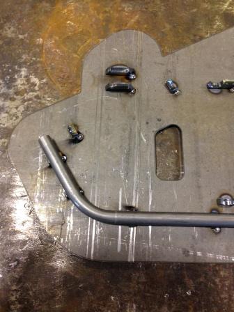

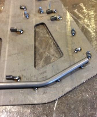

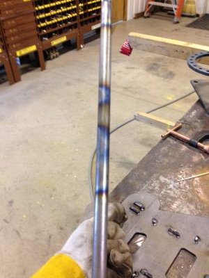

Front bottom rail bent
Front of bottom rail being marked for bending
Rear bottom rail kick up. First thing is to figure out the starting of the bend.
End view of frame showing how straight it is..Good jigs = perfect parts!!

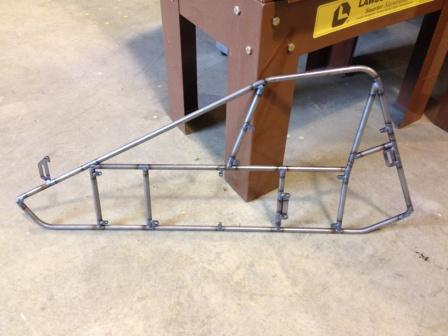

Frame side after pulling it out of the jig

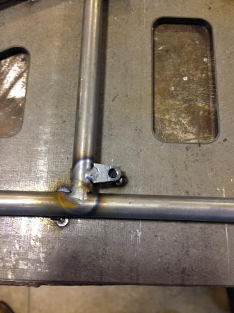

More detail pictures of left side of chassis
Front radius rod mount L.S.
Rear radius rod mount L.S.

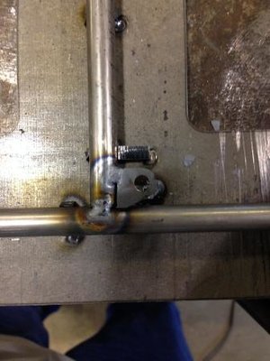

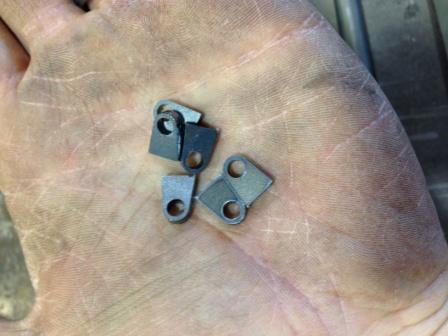

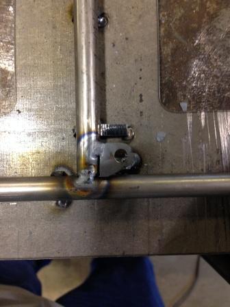

Installed body tab
Installed body tab
Body tabs, we are the only chassis manufacturer that puts them on the frame.. I dislike zip ties!!!!!!!!!!
