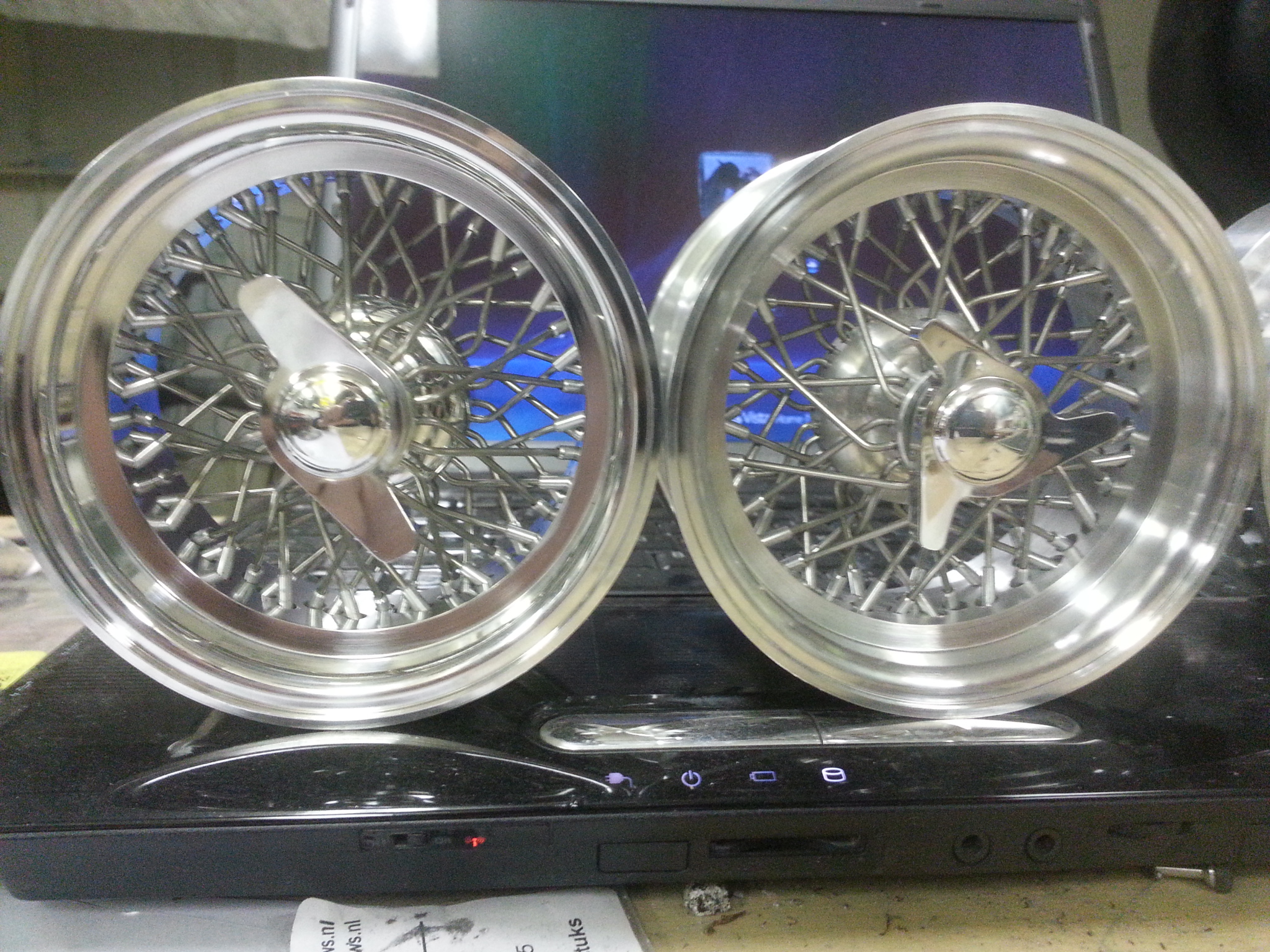

It is a copy from a Borrani but soon al so a copy of the original Cobra.
The Borrani was the most difficult.

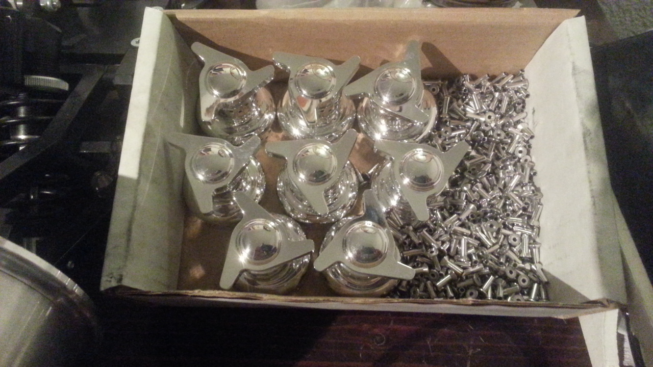

60 spokes.(I know, the real one has 72 but it is not possibele within this size....) Stainless steel, 1,6 mm. Nipples custom made of aluminum.
Size: diameter same as BRP. Width from 2 inch to 3 inch and a bit bigger because of the 250 GTO.
Three different spokes and three different angles.
Takes 2 days to polish and assembly 1 rim.... Everyting is custom made.
