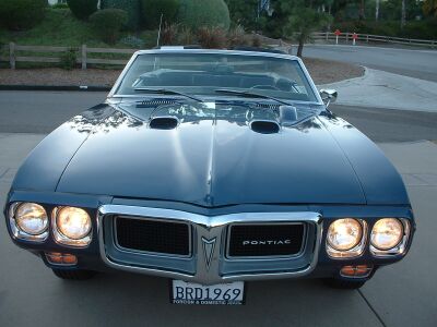

Oooohh... maybe I'll add a bumper/beak to it and make this...
