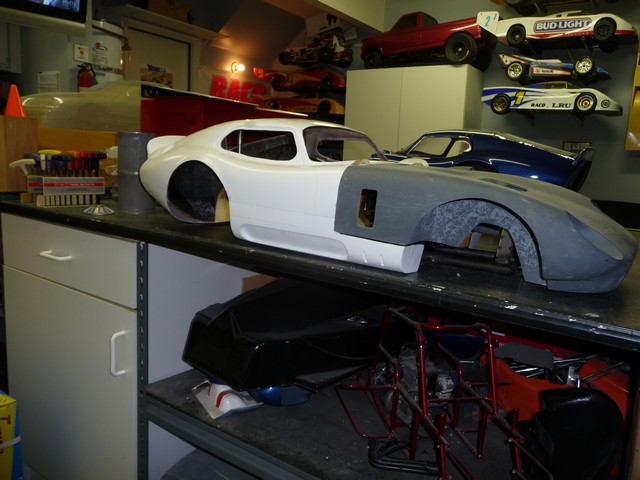

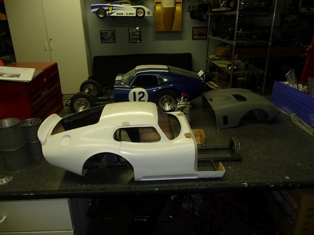

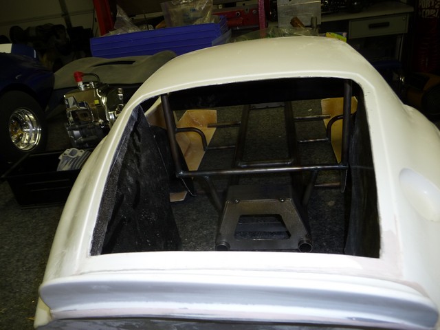

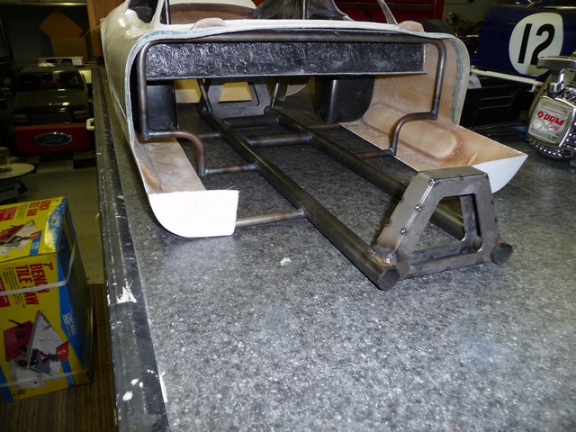

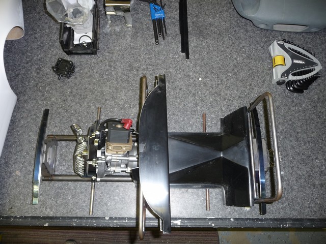

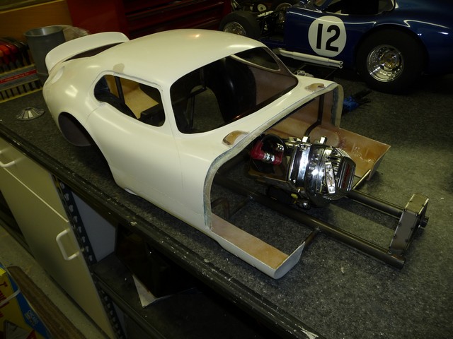

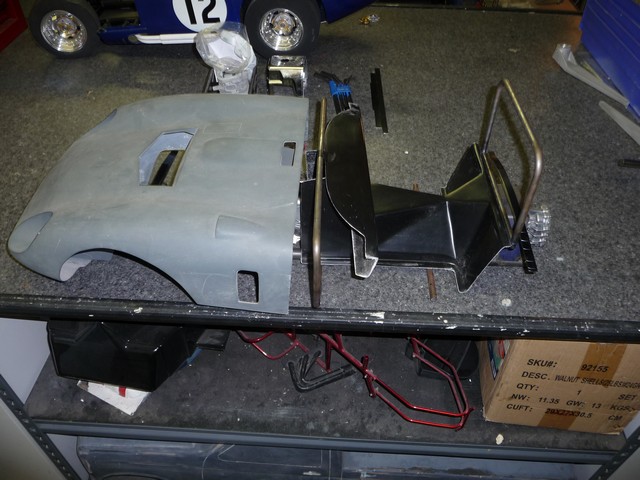

Here are a couple new shots. Some of the bulkheads are tack welded in. There is still a lot to do in both those departments. This is really just a test fit. Also shown is the built engine. It is just about ready. It is a RC260 Zenoah modified to be water cooled. A lot harder then it sounds. It turns out that pretty much none of the boat stuff will bolt right onto this engine and I also had to make new coil mounts since the marine engines have a totally different block as well.

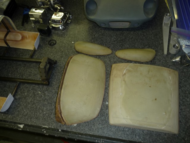

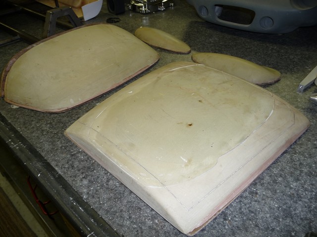

Here are a couple shots of the window molds. These are vacuum forming molds. Problem is that they sat in the dirt in a back yard for 10 years... Soooo they are actually in good shape considering. The rear window mold has the real issue. I had to completely break it to clean out behind it so I could re bond it together. Now I neeed to fill the cracks and feather it out.

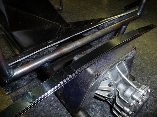

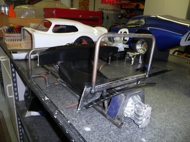

here are some more progress pictures. made some adjustments to the chassis and made the front and rear leaf springs out of spring steel. Much better the the material used on the original car that eventually sagged.
