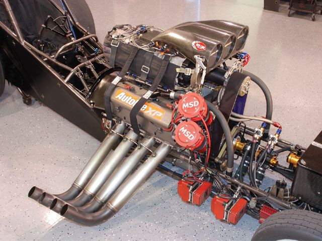

But, in the drawing, it appears the motor is too small. Look at the motor in Force's car (EDIT: Tasca's) compared to the size of his rear tire. With the setback blower extending backward, dual mags and fuel pumps in front, you get almost FOUR feet of motor.
I believe the chassis are (by NHRA rules) limited to 125" max. Rear tires are ( I think) 36" diameter. But our 2-stroke engines aren't all proportionally "scale" compared to the size of a real nitro motor, you also have no driver, two or three servos, a receiver fuel tank and other non-scale items you have to accomodate.
You could build one tube-for-tube scale, but then you'll just have to go in later and chop out frame rails for clearance and add mounting tabs and plates for the RC components.
So... don't fret the "scale" too much.

The 1/4 scale "Hawk" plastic Hemi motors are true 1/4 scale, but the modern nitro motors don't look anything like those old 1970's hemis anymore.
Modern nitro motors have dual-plug heads, dual mags and huge fuel pumps, ballistics blankets over the blower and covers over the spark plugs, setback blowers and those ugly buzzard-catcher scoops.
If you want to do a scale modern nitro motor, that was the best idea, get a new Diecast (especially those 1/16 scale ones) and multiply the dimensions by four. Those are the only accurate scale renditions of the new nitro motors that I'm aware of.
There's one guy I know in the hobby industry who's an expert in large scale electric power, Chris Fine at Fine Design RC. If you told him what you were doing, I'm SURE he could steer you into a motor / esc/ battery setup that would work.
I LOVE the idea of an electric Q-scale, and I know there are a couple of guys lurking in this thread that have some high-voltage tales to tell, too....
