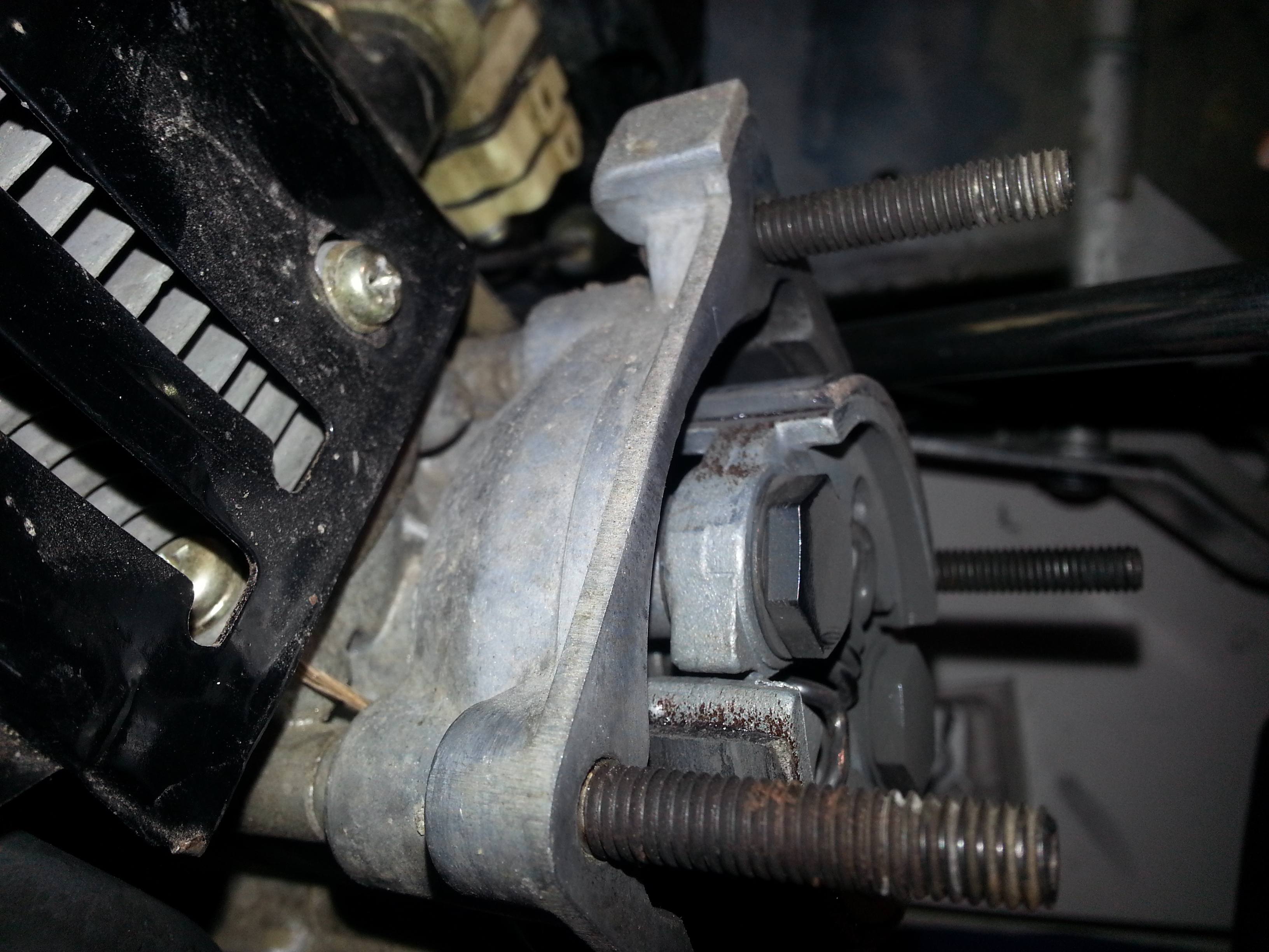

Clutch spring needs replacing......I can one shoe not touching the rest. You can buy springs on eBay cheap. I don't recommend going with the high RPM spring maybe 6-7,000 rpm or so.

Yes I see that to. Both shoes should be touching on both sides where the bolts are. Actually, I would buy new shoes and spring. those shoes have been known to break where that slot is in the shoe. I had it happen to me.

There are no bolts holding the engine to the chassis. All of the engine's weight is being held by the bolts of the clutch coupling, which go through the shock tower and then bolt into the gear case. Also, nothing is bolting the the gear case down- currently, it's only screwed into the shock tower. Basically, everything is hung off of the shock tower, causing the whole setup to be loose and causing the engine to move /bob up and down when being revved up.
Could the looseness of the clutch shoes be the cause of the squeaking? I'm looking on eBay for replacements.

There should be 2 metric screws at the bottom of shroud under the pull start.I hope the mounts are not broken.
Re: New guy- RACO Jack Rabbit Restoration and Issues
Those mounts seem to have been broken off- take a look at the large holes in the plastic. Any suggestions for how I can repair that? The clutch bell moves back and forth a little bit (+/- 1mm) but I suspect that is for tolerance.

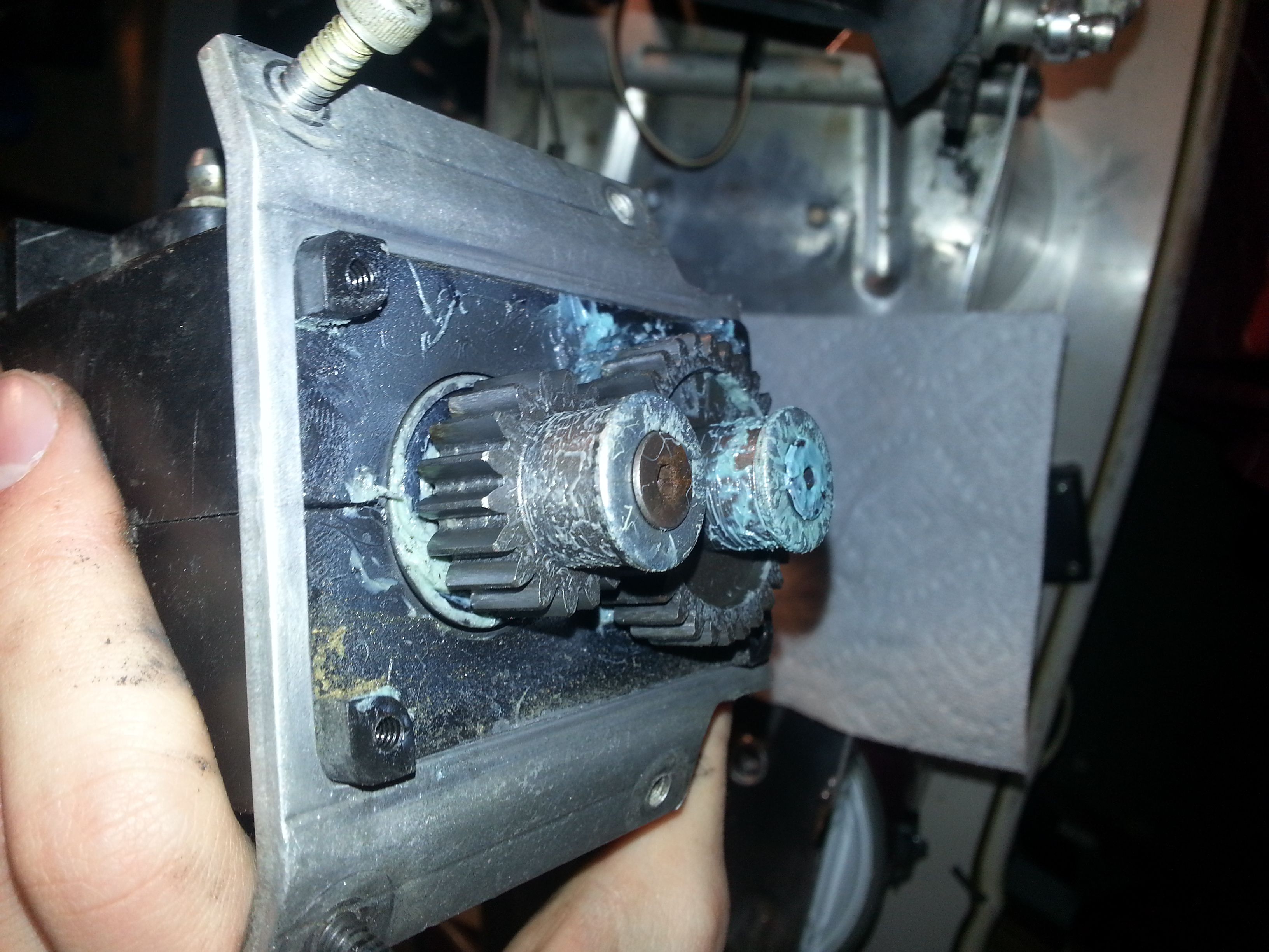

I took a shot of taking apart the gear case. I couldn't get the front half off- the seam looks like its fused, or maybe just really tight- I don't think I should force it. From the outside looking in, everything looks well greased. Take a look at the rear gears.
What is wrong with the clutch spring & shoes rubbing? Could they be the squeaking issue? I'm trying to keep the budget as low as possible and would like to avoid an necessary clutch purchase. If it helps at all, this just came to mind, in a lot of YouTube videos, Jac-Rabbits idle without moving. Mine moves slowly when idling unless the brake is applied. Is it time for a new clutch (shoes & spring)?
