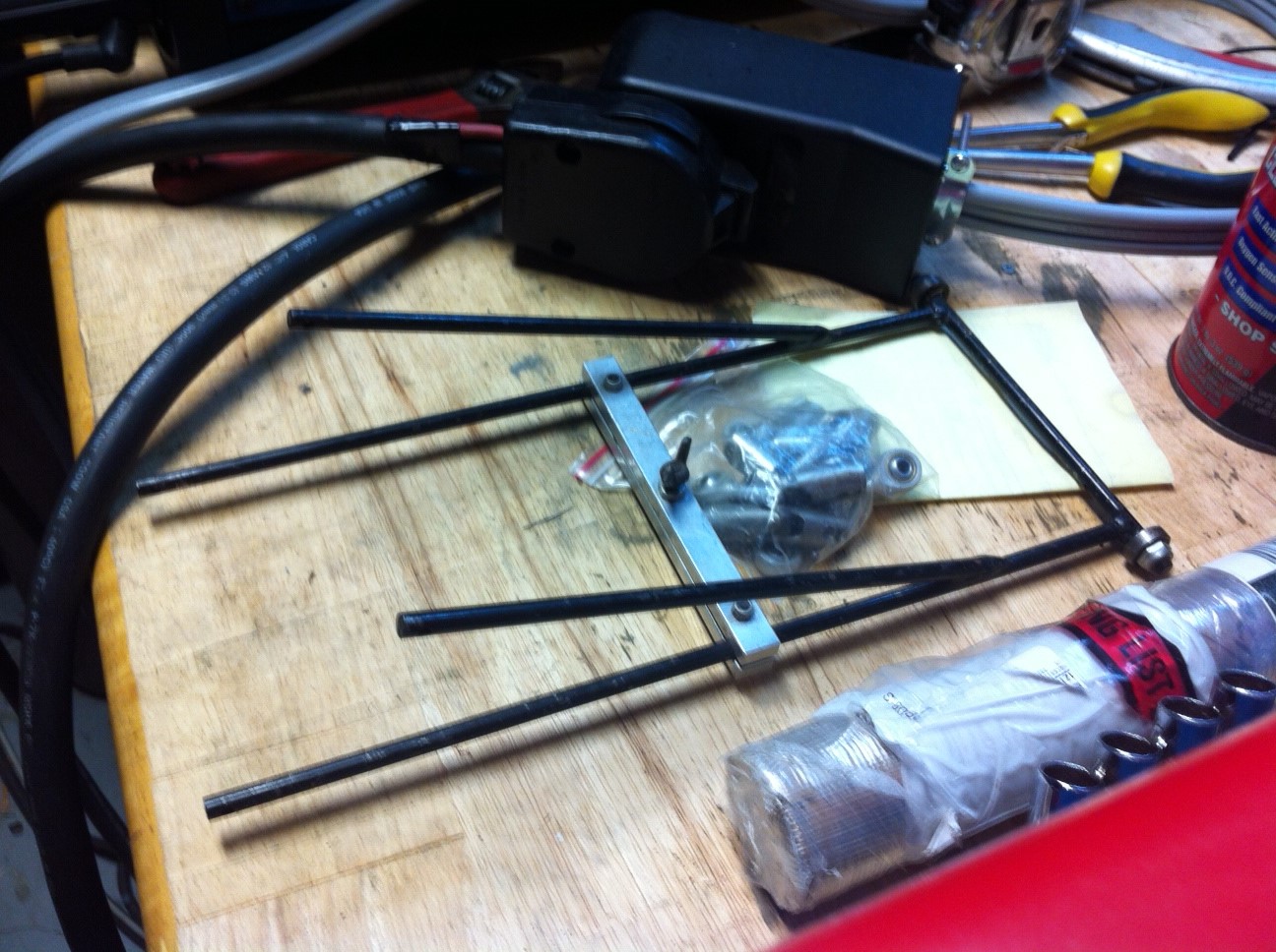

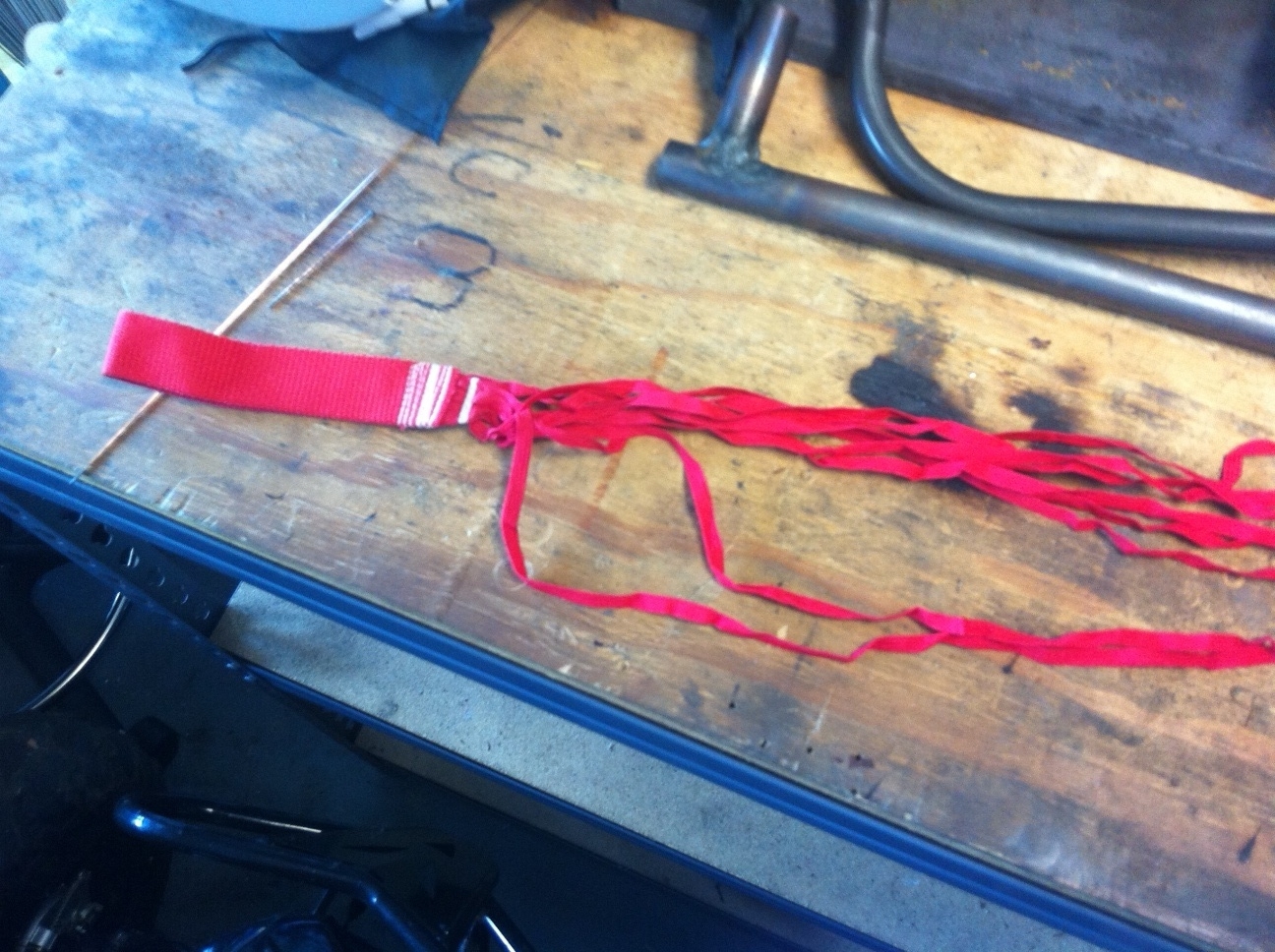

here are some pics of the chute. sorry for the delay.
thanks

The spring is on the pilot chute. The pilot chutes job is to get the pilot chute out of the pack into the air stream. Once there its job is to pull the main chute out of the pack in to the air stream. The spring goes in last. John

Yup.. Chute in first, then the spring. It's the same design as any fuel car today. (All pro stock cars use an air launcher, totally different) Fold the Chute, put it in the pack, then the spring. On the end of the spring, is a loop, and that loop will need a guide wire to pull the loop through the holes in the chute pack. It looks like yours has the guide wire on it already. So, put the spring in, and compress it, hold it in with one hand. Take your other hand and run the guide wire through the holes in the chute pack. Most packs have 2 rectangle flaps, and 2 triangle flaps. Do the rectangle flaps first (top and bottom) and pull the loop on the back of the spring all the way through. Then do the 2 side flap, and again pull the loop through via the guide wire. So, now, the chute should be totally packed, and the guide wire has the loop pulled out of all 4 flaps. Now.. Take your chute release cable and put it through the loop. The chute should now be all contained. Once you have the chute release wire in, you can remove the loop guide wire and put it away till next time you pack the chute. Now, once that chute release cable gets pulled out, the spring will be able to push through the flaps on the pack, pulling the main chute out.
