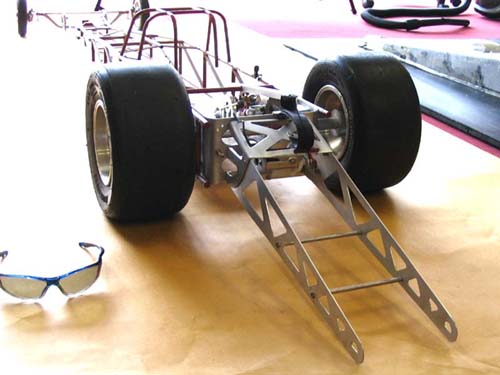

Wow, Stoney...those look the goods....

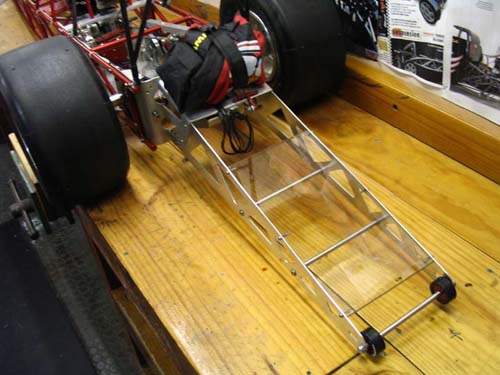

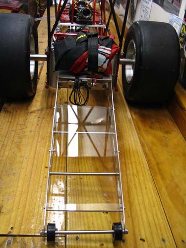

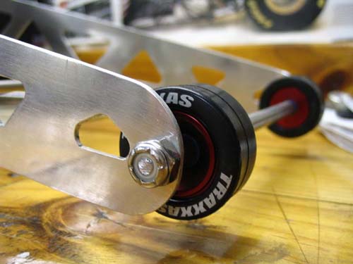

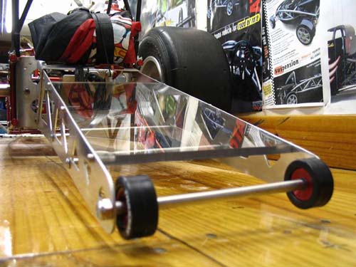

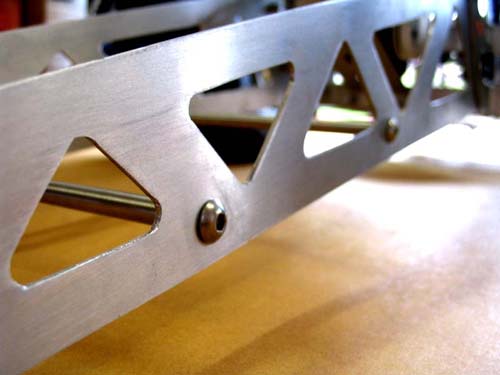

Gday 2pock,
I made a wheelie bar for my rail, but instead of scale realism, I went toward the RC look.
My wheels come from the wheelie bar from a Traxxas Jato (only coz they are red)
the sides are hand cut n filed from old road signs (aluminium)
All my road signs have come from the Council guys pulling down old ones and putting up new ones - I didn't nick them!
Thanks to the council guys for giving me the old ones BTW
I just put a piece of 1/4" polycarb on the top for a surface to bounce the chute off, and stiffen things up a bit. The cross braces are S/S tube, threaded to M5 to take the M5 S/S button head Socket head cap screws & the wheels sit on a 3/16' threaded rod with S/S tube spacers... - I hope this gets your brain ticking into how you could make some for yourself...
cheers 8)
Wheelie Bar 002.jpg (30.71 KiB) Viewed 15745 times
Wheelie Bar 003.jpg (35.7 KiB) Viewed 15745 times
Wheelie Bar 004.jpg (46.27 KiB) Viewed 15745 times
Wheelie Bar 005.jpg (46.42 KiB) Viewed 15745 times
Wheelie Bar 006.jpg (47.16 KiB) Viewed 15745 times
Wheelie Bar 007.jpg (52.53 KiB) Viewed 15745 times

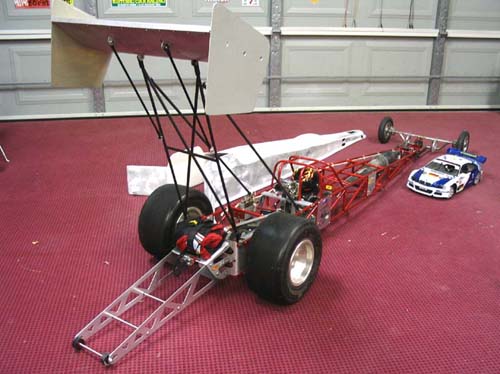

I couldnt fit this one in.. only 6 x photos allowed at a time... this was supposed to be
No 1 photo
Wheelie Bar 001.jpg (39.06 KiB) Viewed 15745 times

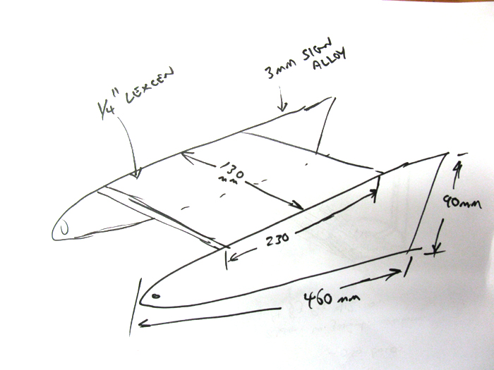

Heh Muddy, can u get me the dimensions on ur bars? They look alittle easier(lol) to make than Stoneys. No disrespect to Stoney intended. But if u can, shoot me the dimensions.

Sorry for the delay, I was just looking at this post today.
A rough sketch of what I did. Should help.
