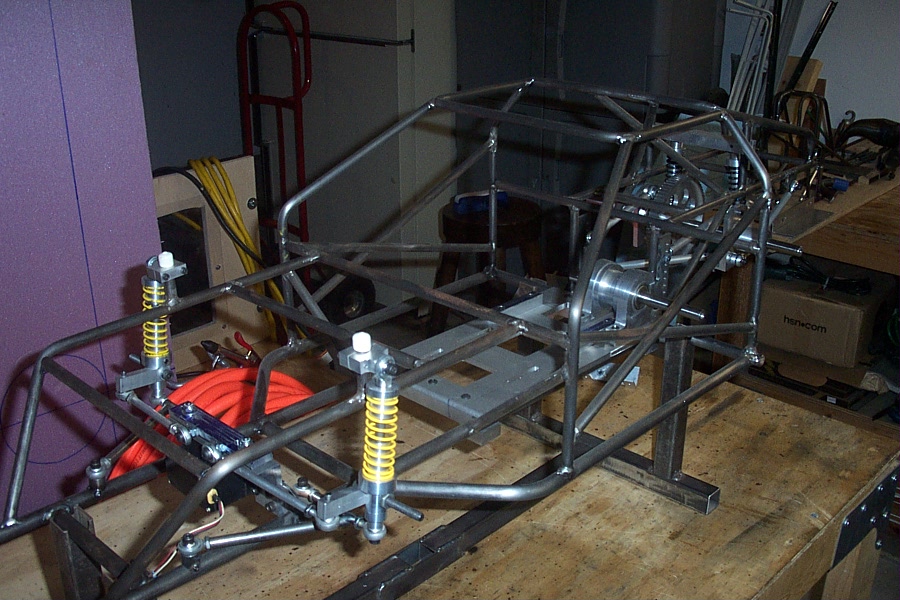

I use D.O.M steel tubing with .065 wall.
Mike
Pro-Max Performance

Some of the numbers came from my old New Era pro-stock chassis. The front A-arms on the New Era from the center of lower chassis bar to the center of the rod end is 3 1/4 ". On my car I have them at 3". Good luck with your project.
