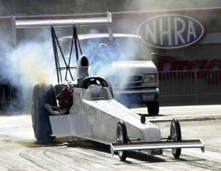

By the way, that car all in white, with the abbreviated nose, looks sooo much like Ashley's A Fuel car looked in testing in 2004. I saw it in the shop later as they were putting the "Toy Store" lettering on it.
I probably have a chunk of Lexan downstairs big enough.
