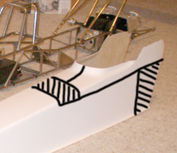

Got home from Chicago today to find UPS left me something while I was away for the weekend.
It's a little long, but it will work fine! I just need to shorten it up a bit.

Re: 1/4 Scale Top Fuel Dragster PROJECT!!!!
Interested in seeing your crop and chop job. I wish those stinking bodies were shorter. I think they were for bill cains TF dragster that was built like the quartermortar car.
I'd sure rather SHORTEN one than try to lengthen it. I think I'd shorten it from the back, unless it needs to be full height around the cockpit to cover the tubes.
