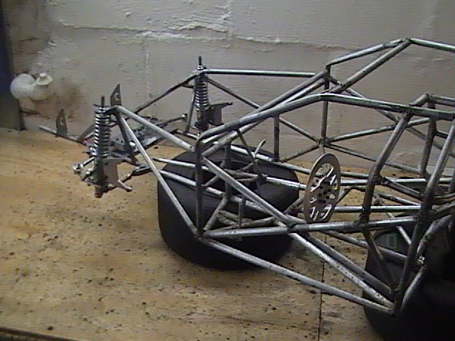

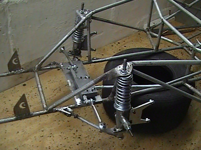

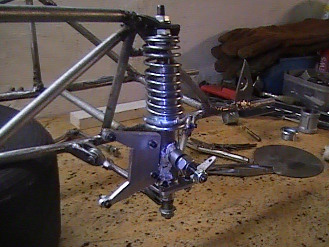

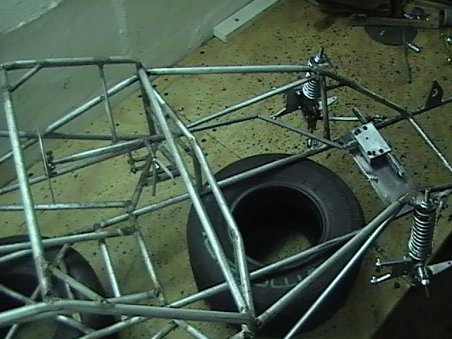

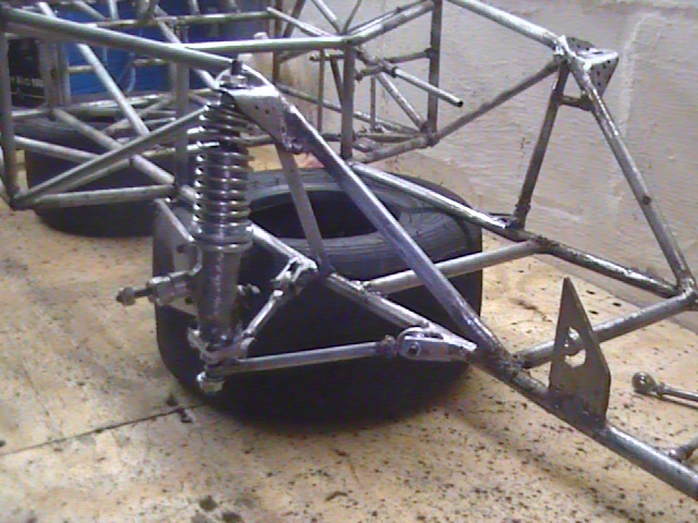

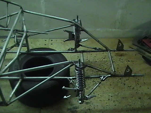

Well i now have one of the front struts fitted with the spring... I will need to alter the lower control arm bracket and shorten the shock shaft by 3/4'' here are a few shots of it..
I'll post more pics once i get them altered and installed!!

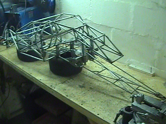

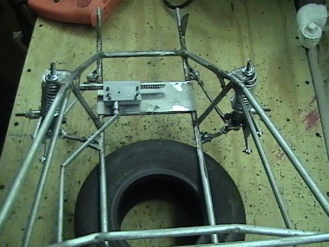

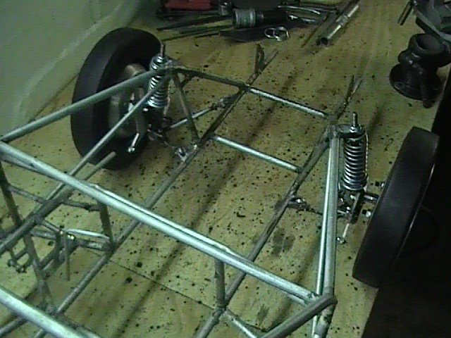

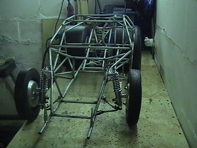

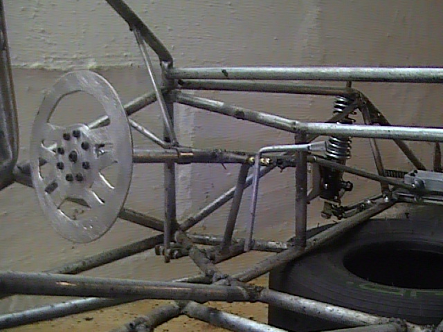

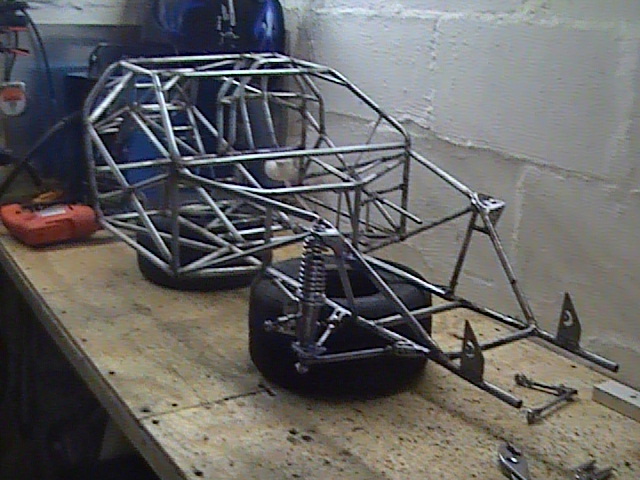

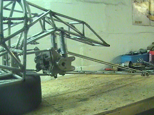

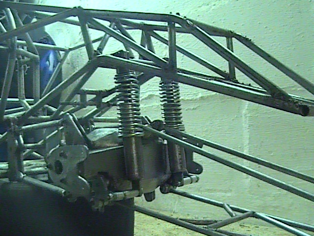

Well other than some minor spring retainer adjustments and a tad more welding/grinding the springs are installed and work great.. It has 1 1/4'' of travel as it is now... Which should be fine. I'm not planing on taking it down a bumpy street or anything... We have a nice parking lot at the shop so i will most likely do the majority of my videos of it in action there... I had to alter the control arm bracket a tad as well... The bolts was almost in contact as it was...
NOTE:: It looks kinda funky because the rear tires/rear end are just sitting under it...I may even raise the front spindles a tad... As it is now the headers will have aprox 1 1/2'' ground clearance. Which means full travel of the shock would only allow 1/4'' between the headers and ground...
Yeah i hope this type of rack will work... We'll see!!
FM... you and me both my friend.. I mean i do kinda have an idea on what it's going to look like but I'm sure there will be a few mods i will need to do it once i get close to being done...

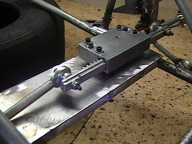

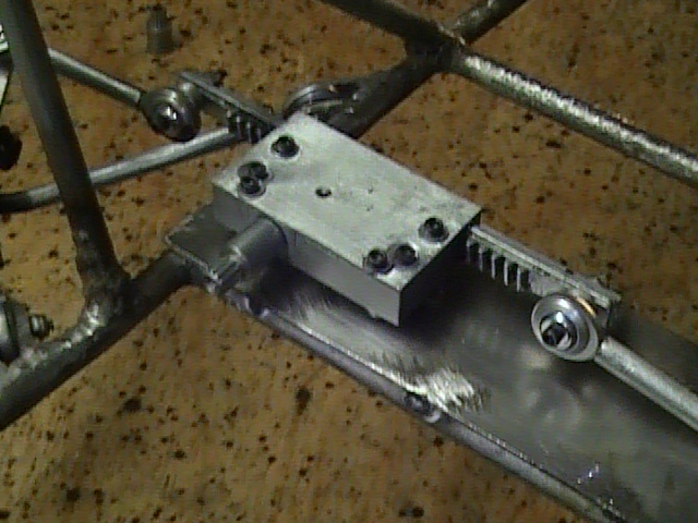

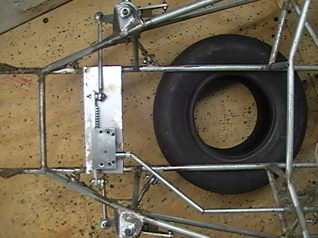

Well i now have the steering rack mounted and mounting plate welded in... I've been looking around for some nice universals for it and located some that may work.. I really wanted to use steel ones but can locate any the size i need that will go beyond a 30 degree angle... My setup angle is 35 degree... I think for a steering system these will work just fine... https://sdp-si.com/eStore/PartDetail.as ... roupID=545
It's in the mock up stage in these shots but i gives you an idea on how it will look.. I'm going to make the Tie-Rods next... Once i get them build and installed i will look around for some rubber boots to cover the assembly.. BTW:: The steering wheel you see in these shots is not the one I'm going to use... This is the one i started to make for my first Beretta build... It's far to big for this application.. And it looks like junk... I'm going to machine one from some 6061 aluminum GT style for this ride..

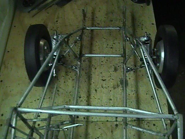

I now have the tie rods done and installed.. There fully adjustable via, L / H - R / H rod ends... The rack works very freely and has little to no friction... Once i get the universals I'll finish the steering & column...

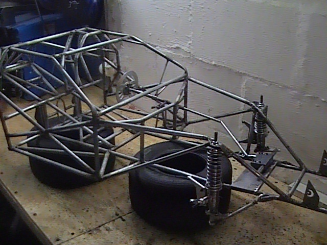

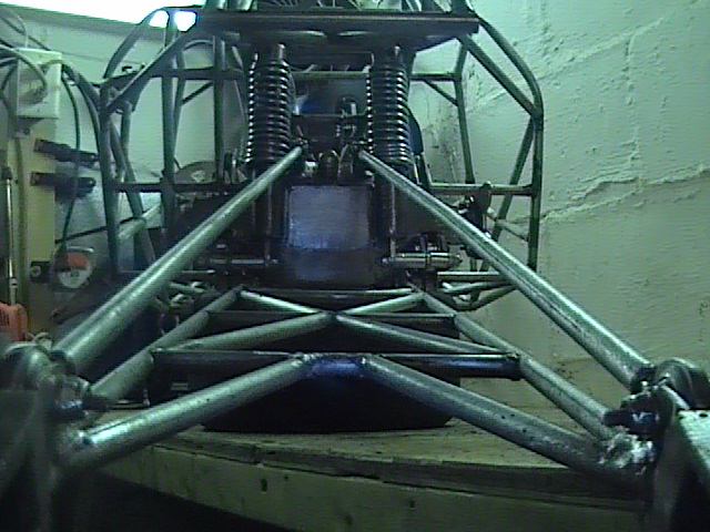

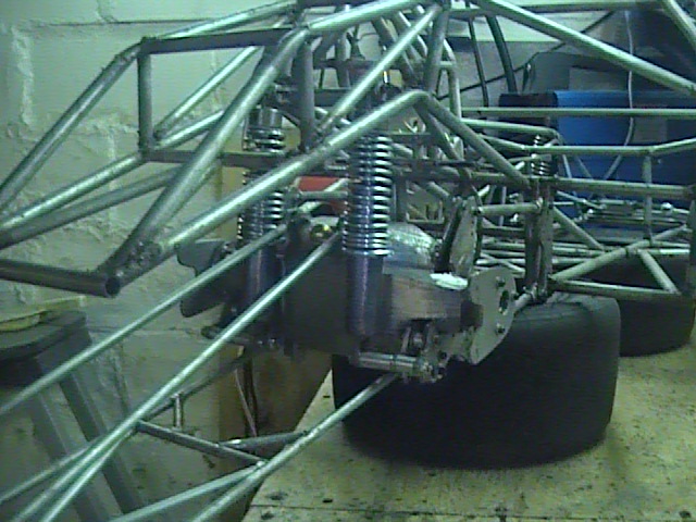

Well i now have the rear springs installed on the shocks.. They work very smoothly... No binding to speak of.. I still need to install the torsion bar & wishbone to do a final test on binding.. But i don't think they will be an issue... I will be taking a video on it within a week or so... I'll have it on my site in the video section.. But I'll post a link to it here as well...
