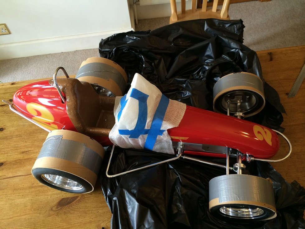

This is how it originally arrived from Gilmer to my home in the UK 6 years ago As it is now. Im going to add engine And for realism Fuel Control system And realistic engine sound I have made progress on some other parts of the car - so more in the coming weeks

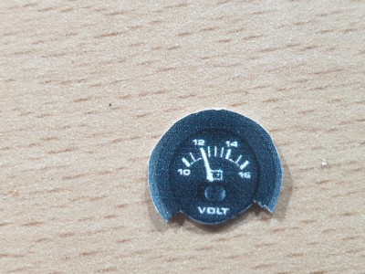

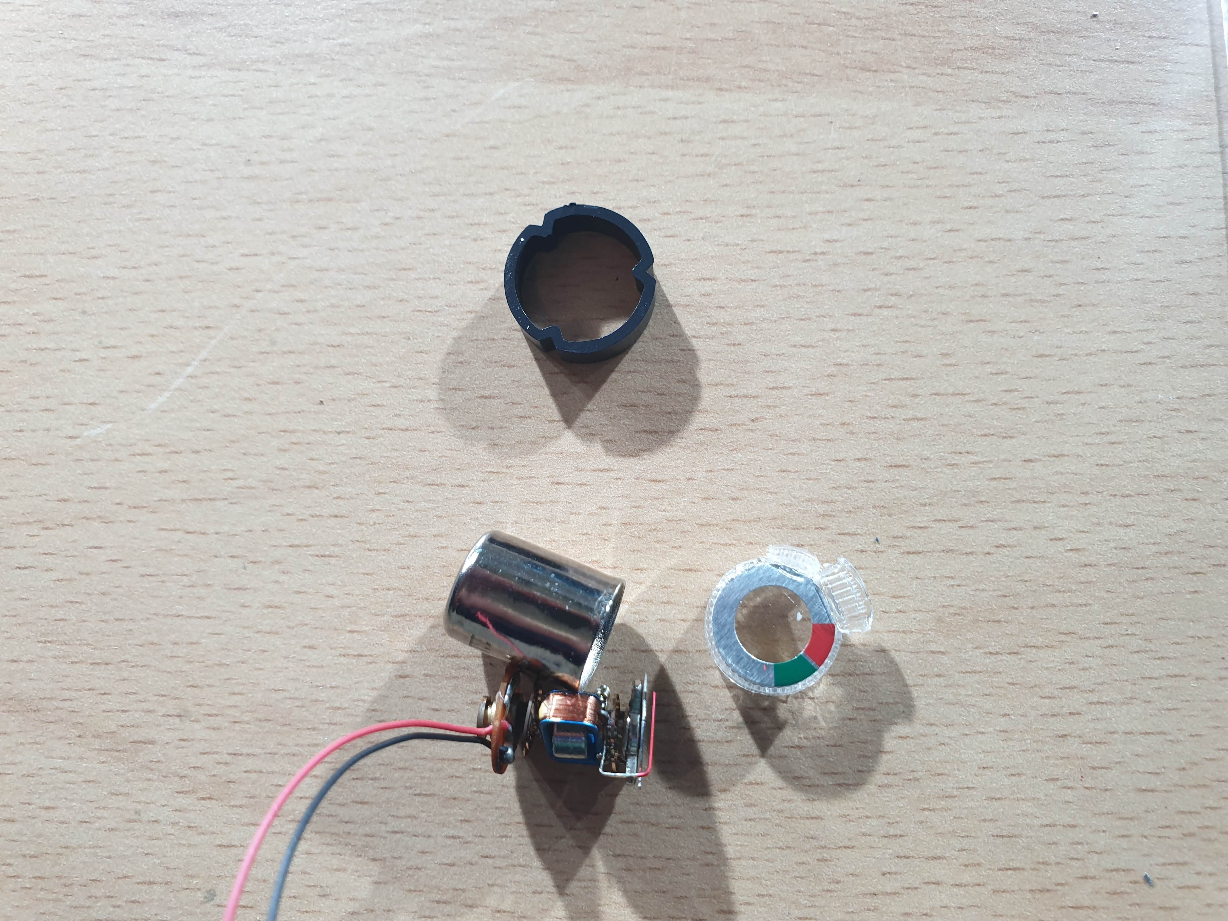

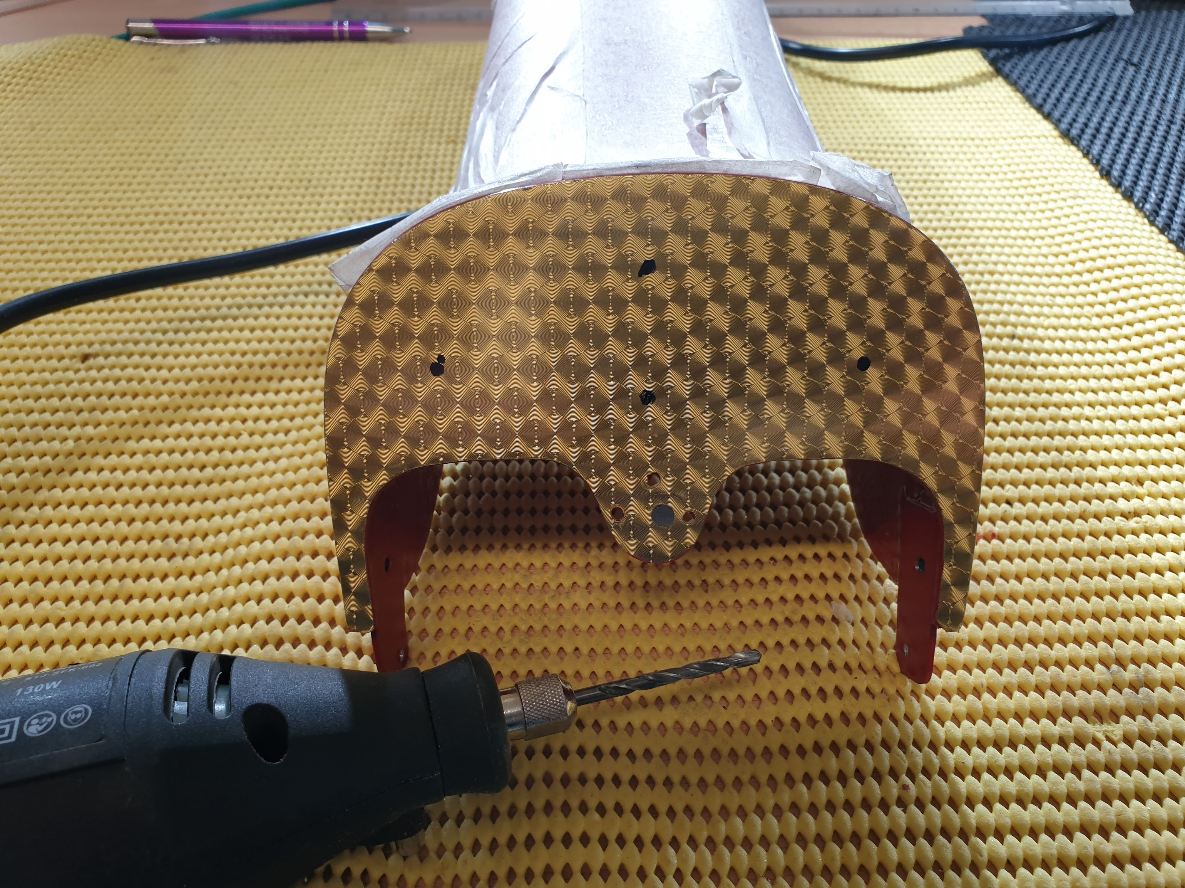

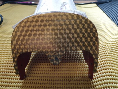

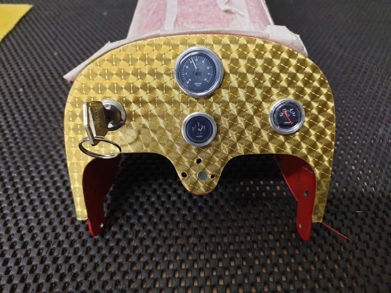

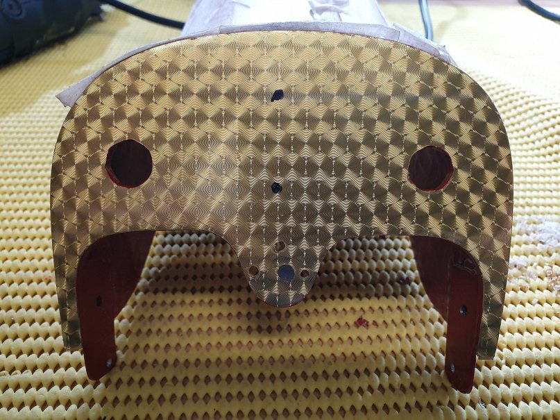

I Went back to the dashboard to add detail - this is how it went.
I used a very small meter took it apart and fitted in custom aluminium bezels I made
You can also see some additional holes at the bottom - these are for the new (working) steering wheel column Holes required for the ignition key and voltmeter - other gauges were glued in place.

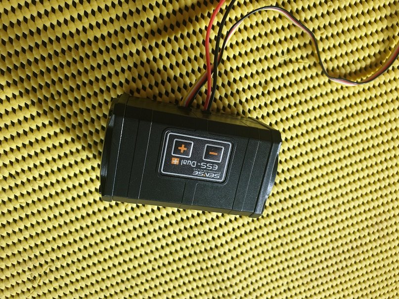

The ignition key works and will turn the engine on / off. As you can also see the engine is reving at 3,000 rpm !

Forgot to add that on my dash the steering wheel hole wasnt exactly in the middle of the dash, and the knee cut outs were not equal - but they are now.
Re: Gilmer project - complete re build going electric
Looks sharp. What’s the mini gauge from?

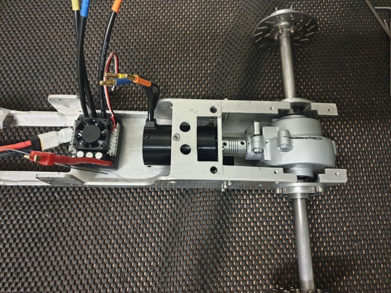

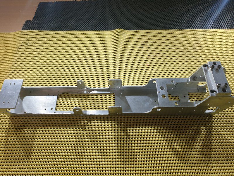

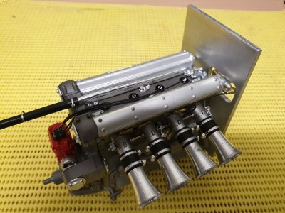

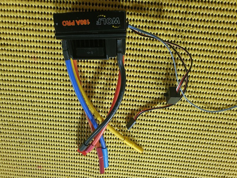

Its been a few months, but I haven't been idle. My first attempt at running with an electric motor was a disaster. I stripped the chassis back first, its already been modified when I had a Saito twin fitted.
Then I fitted electric motor
The gearing in the rear axle was too low and the motor controller overheated and burnt out. So back to the drawing board. I completely rethought the problem and came up with a solution that involved a few of these:
Everyone stay safe.

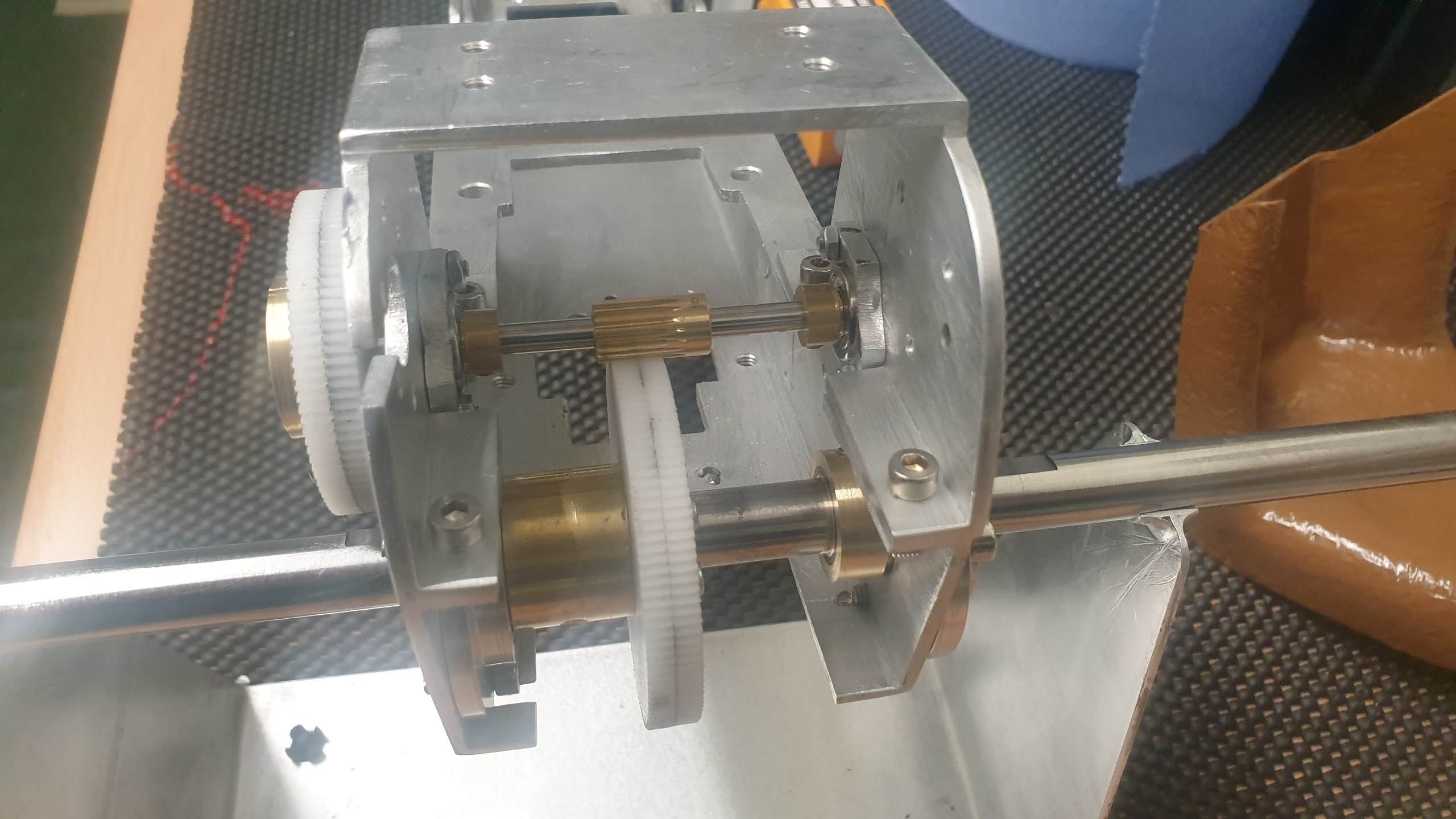

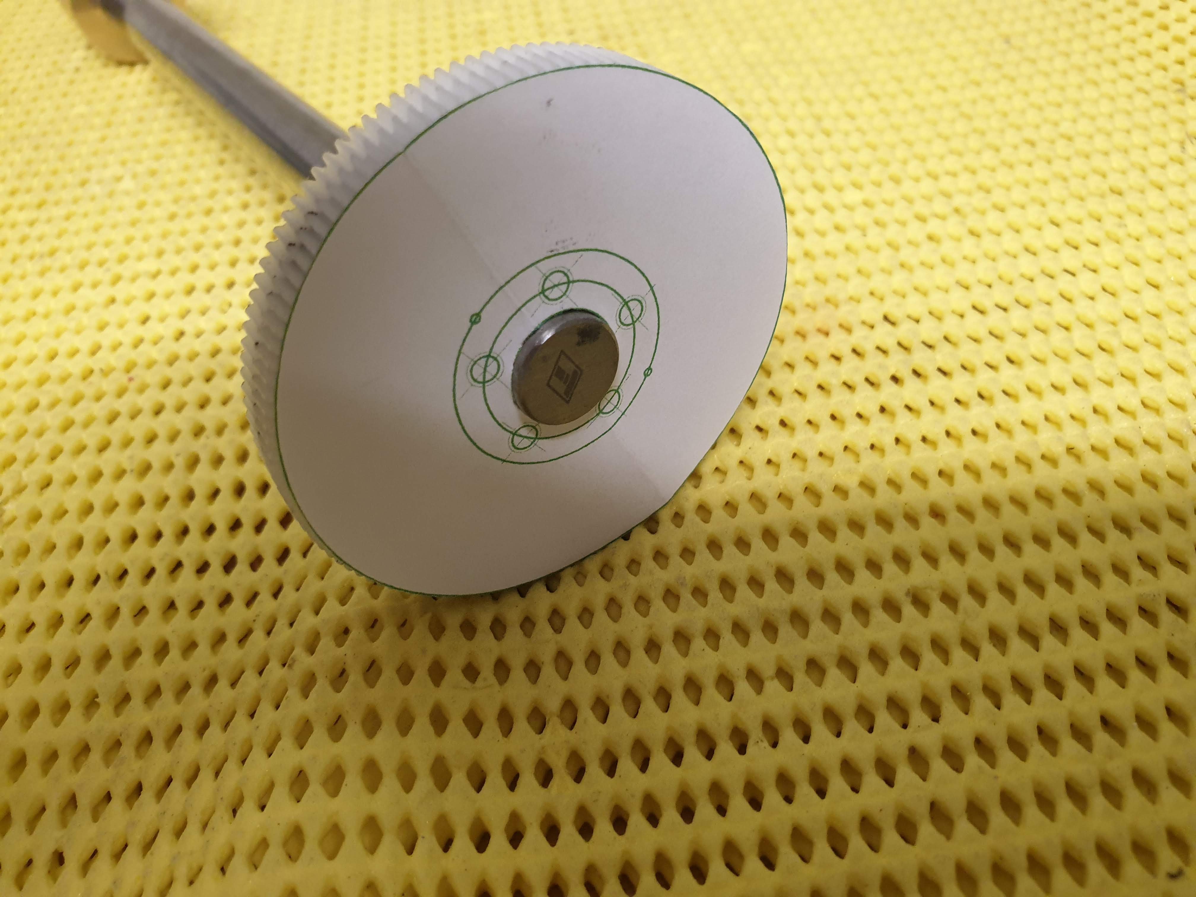

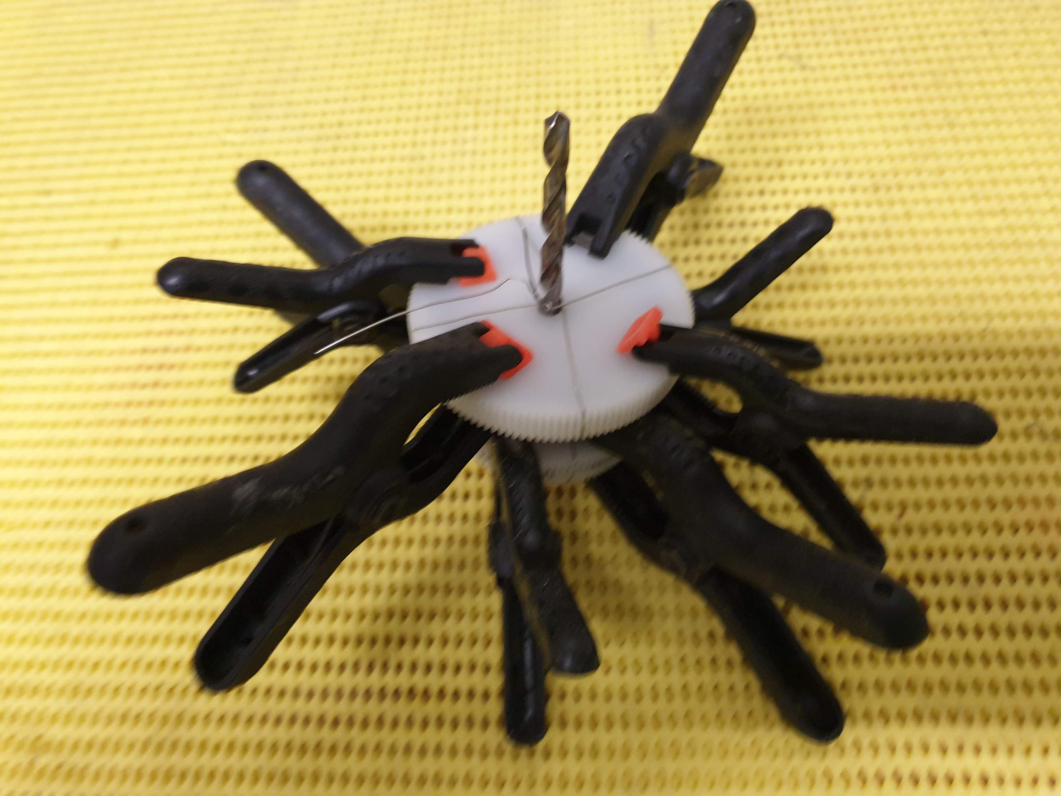

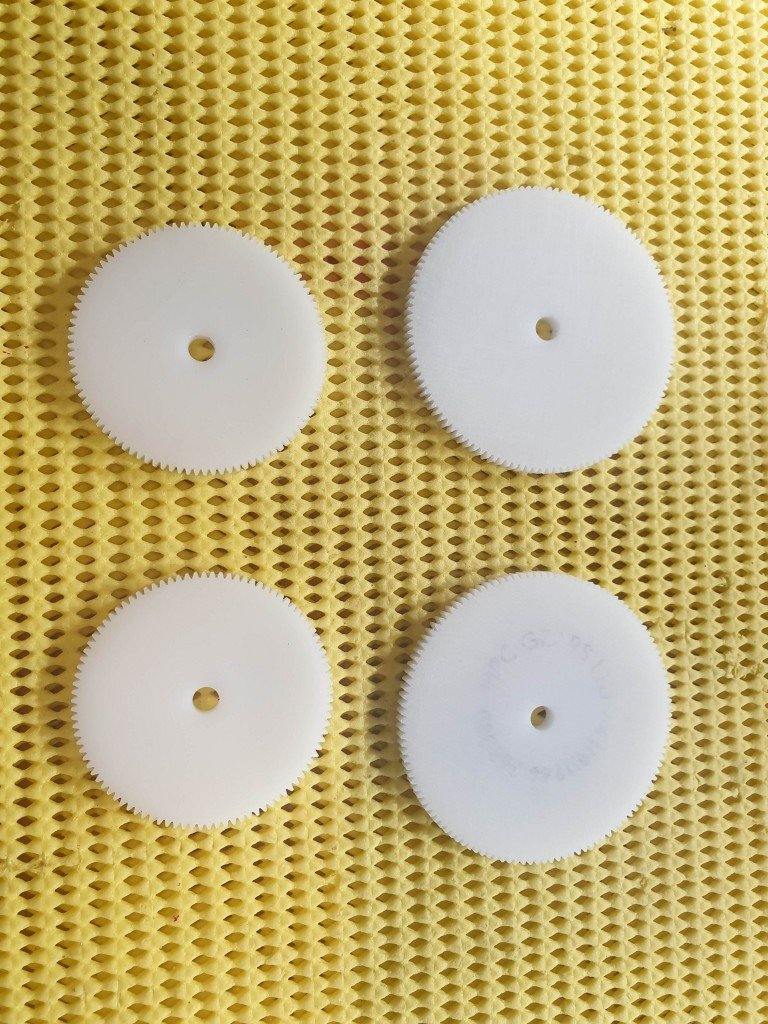

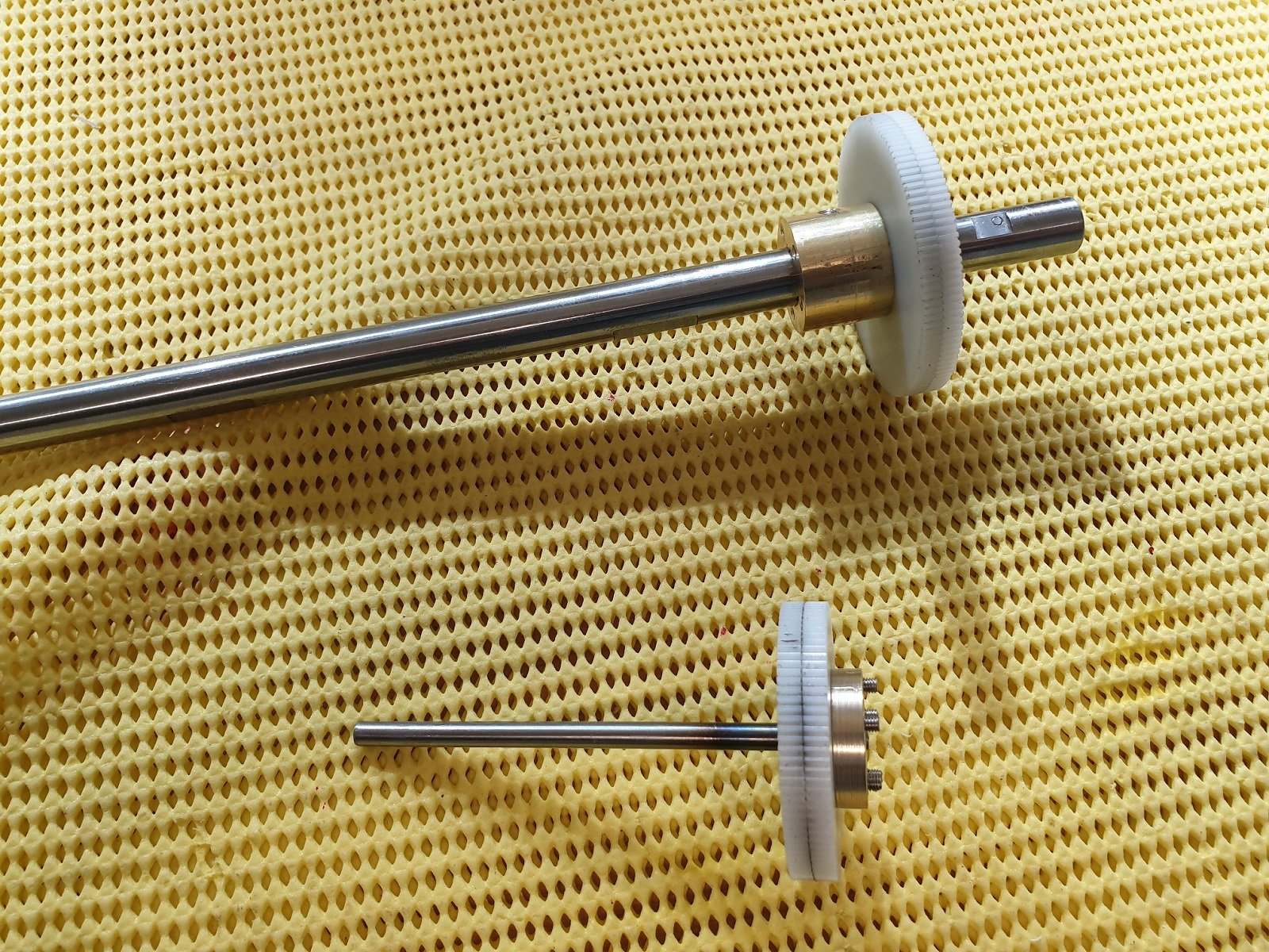

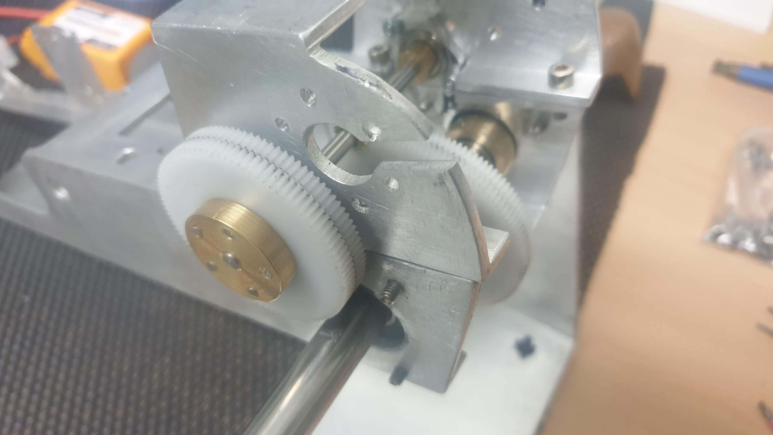

Electric motor build up.

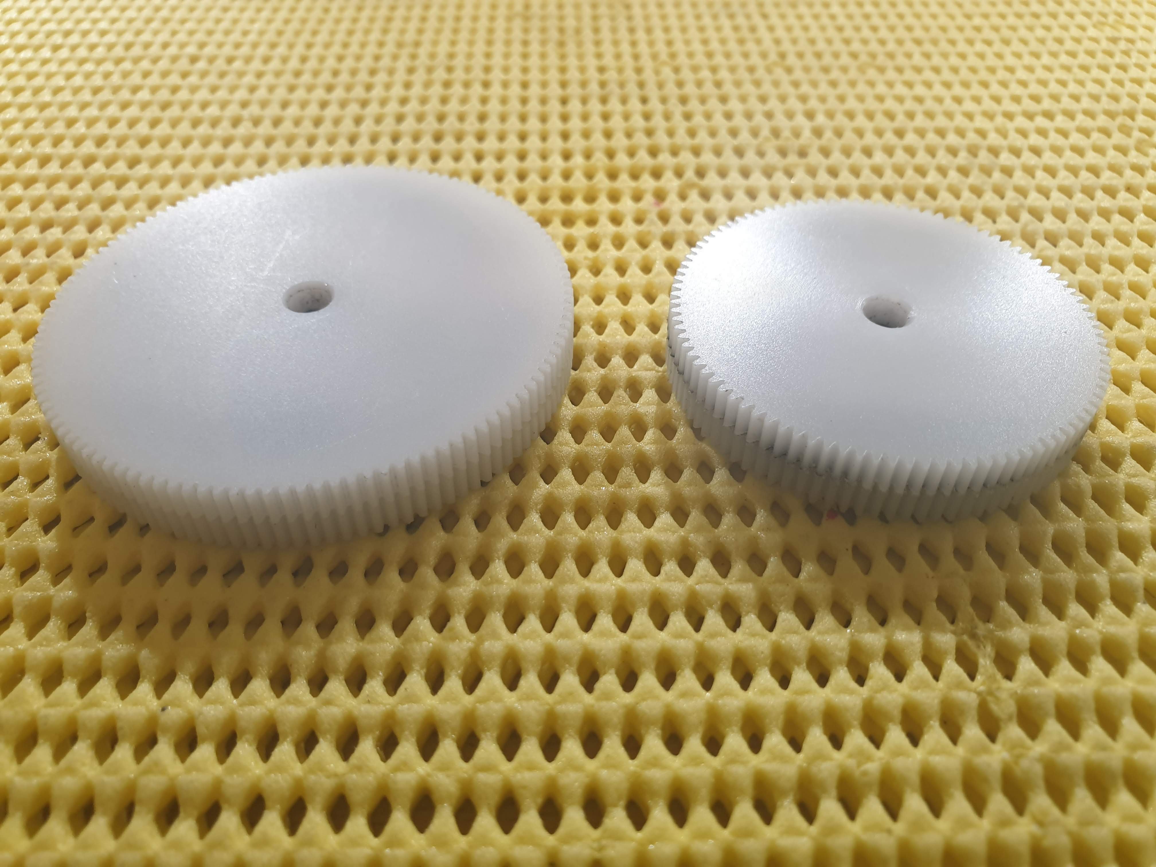

I used nylon gears, but they were too narrow so I joined 2 together, and there are two different sizes needed. They are fitted on shafts and held in place with brass disks

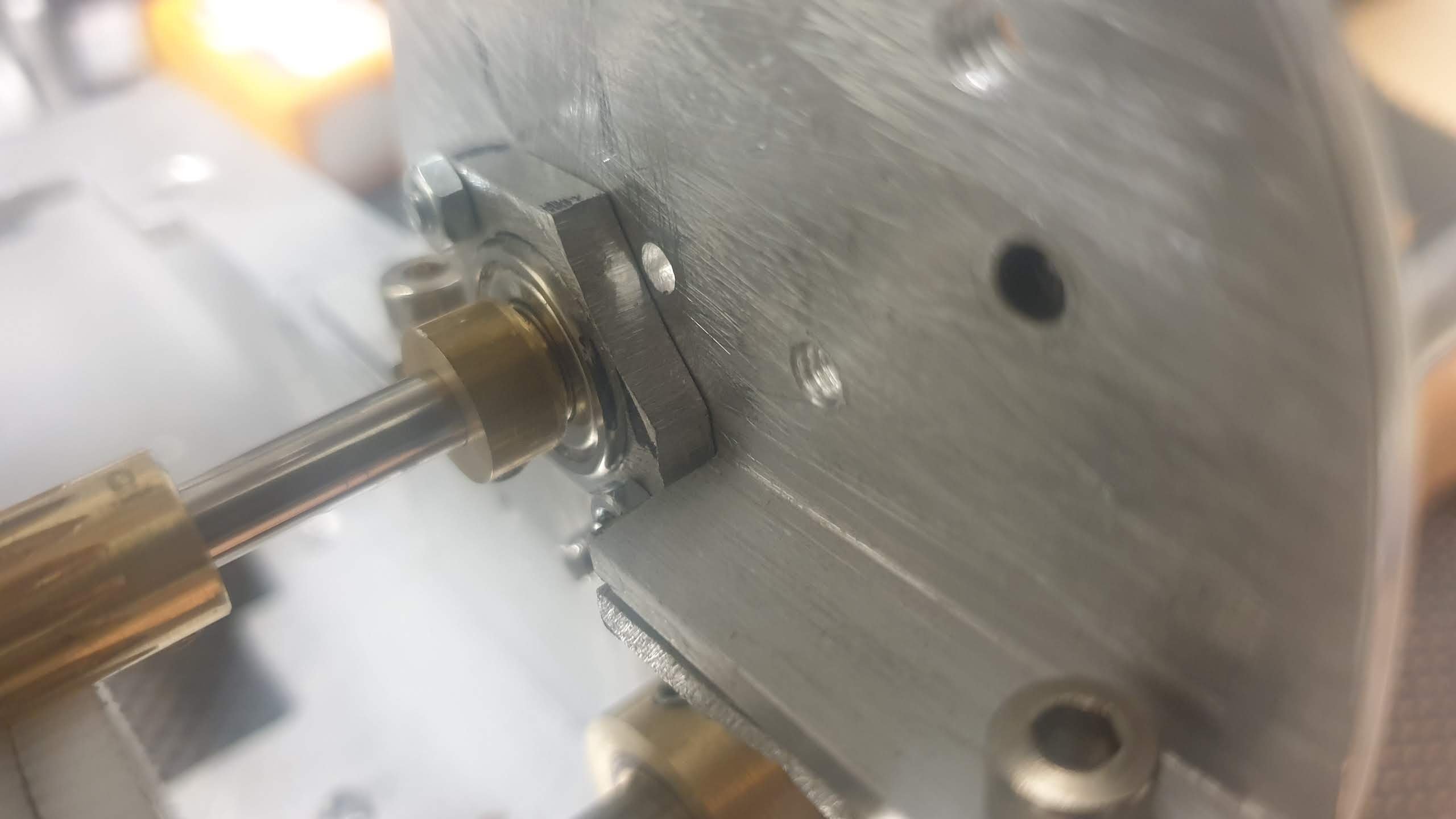

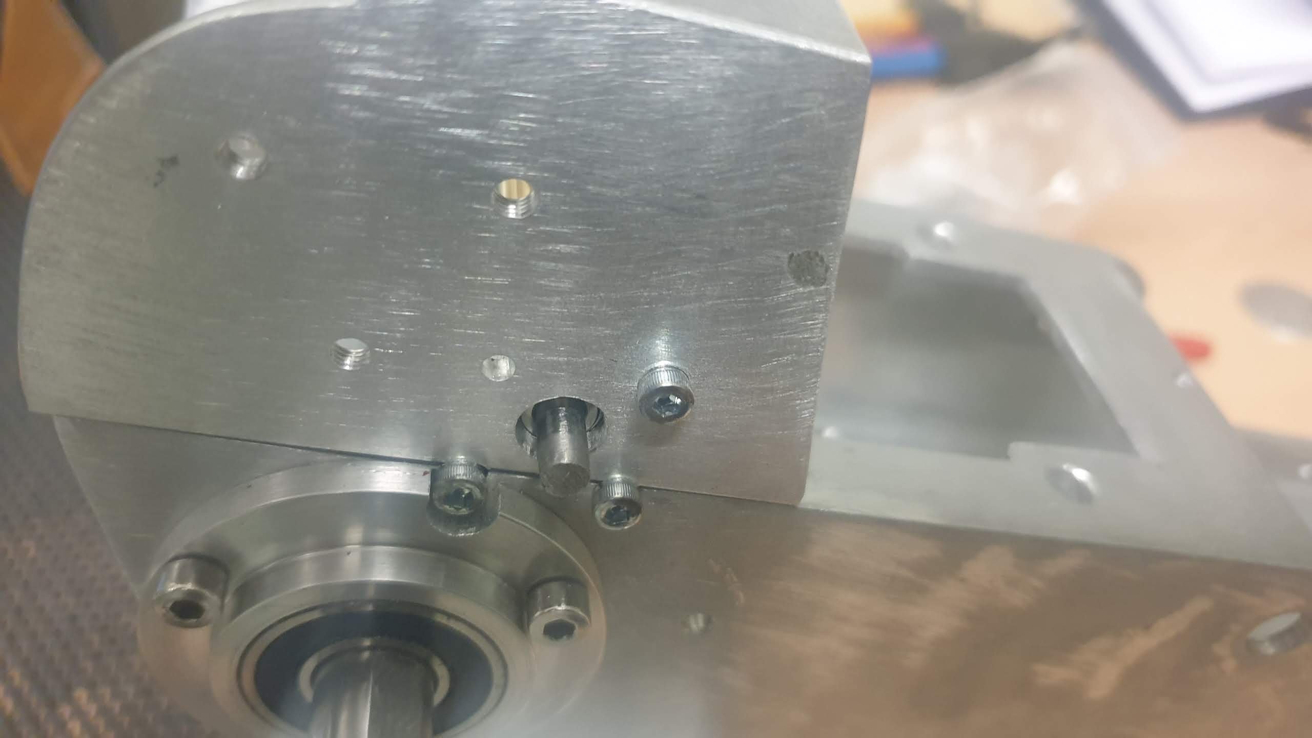

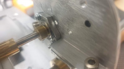

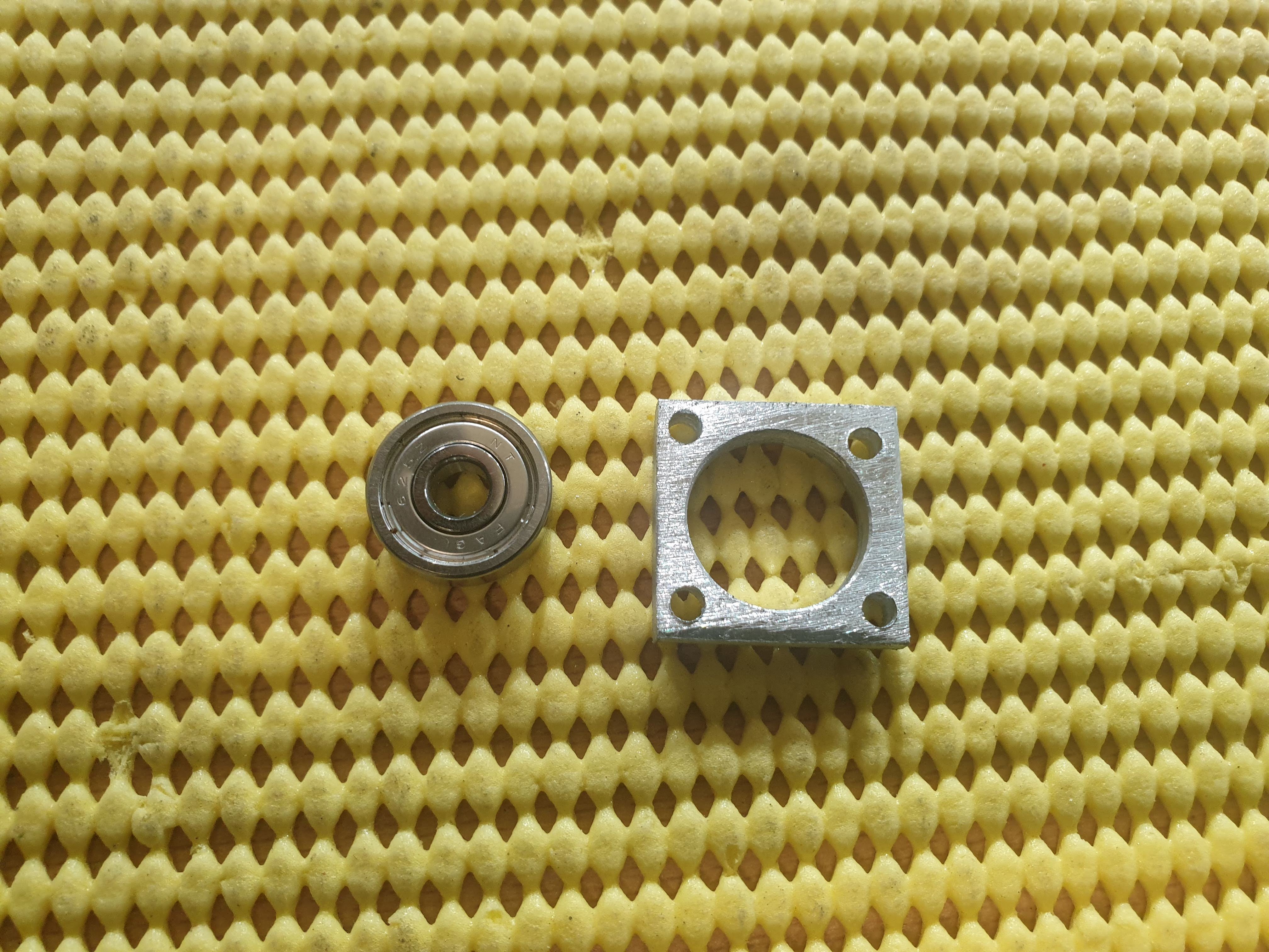

I made some bearing holders - two were required for each end of the shaft.

Assembly of the gears and motor in the frame. This took a lot work to position the gears correctly - not too loose and not too tight so they would bind.

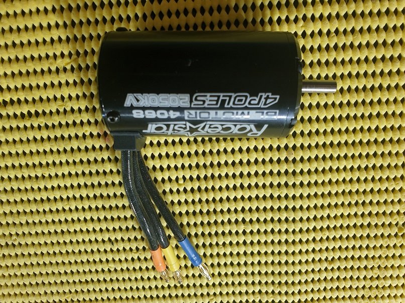

And finally the motor
This was a perfect fit, and I packed the end with 1mm thick Ali sheet held in place with 3 grub screw - so the motor is held firmly in place.
You can see also the speed controller which was placed above the motor as a temp measure to test the running.
