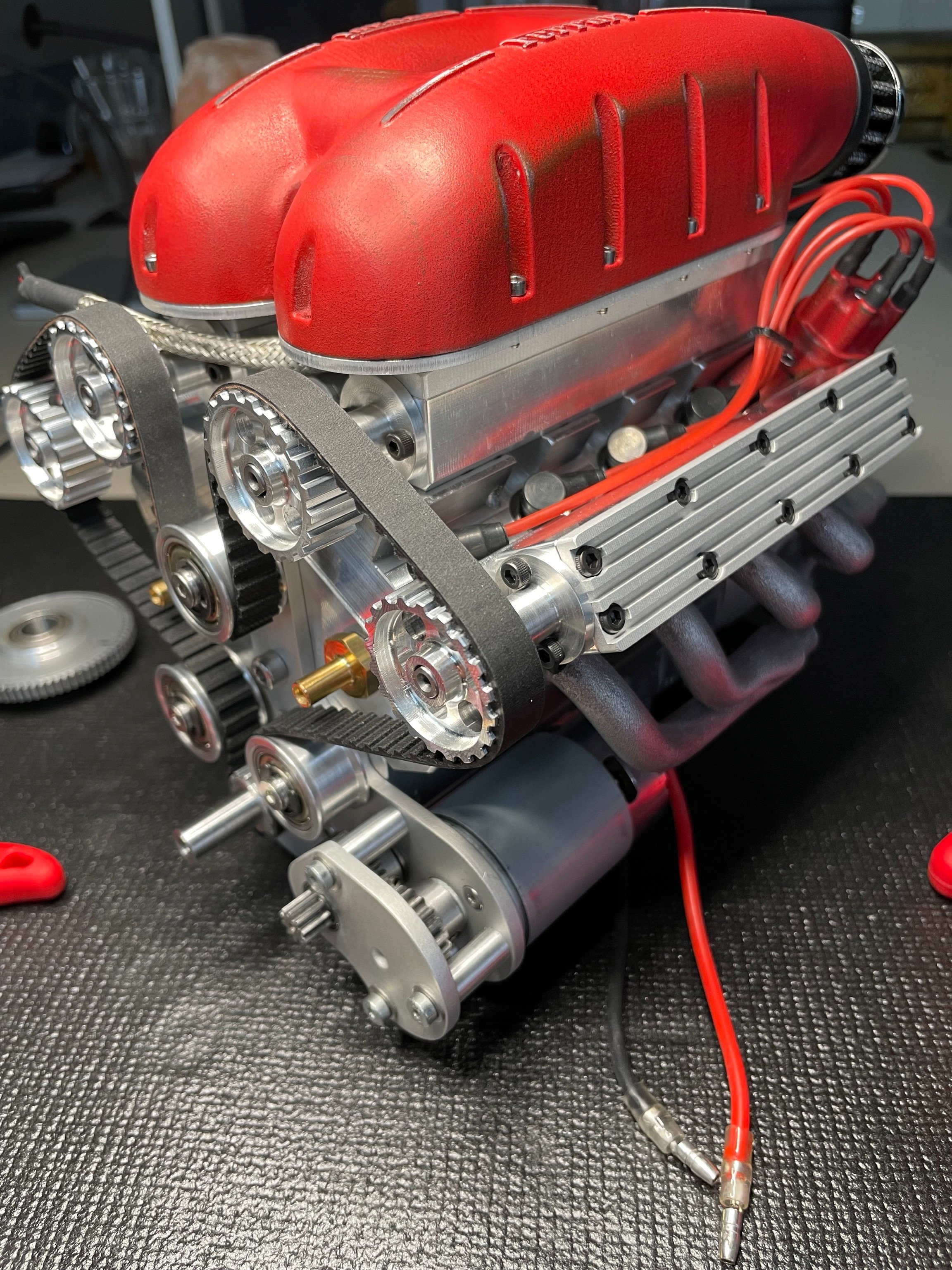

The engine is close to finish. That took me one year. This Winter the tube frame will be done. I keep everyone informed...

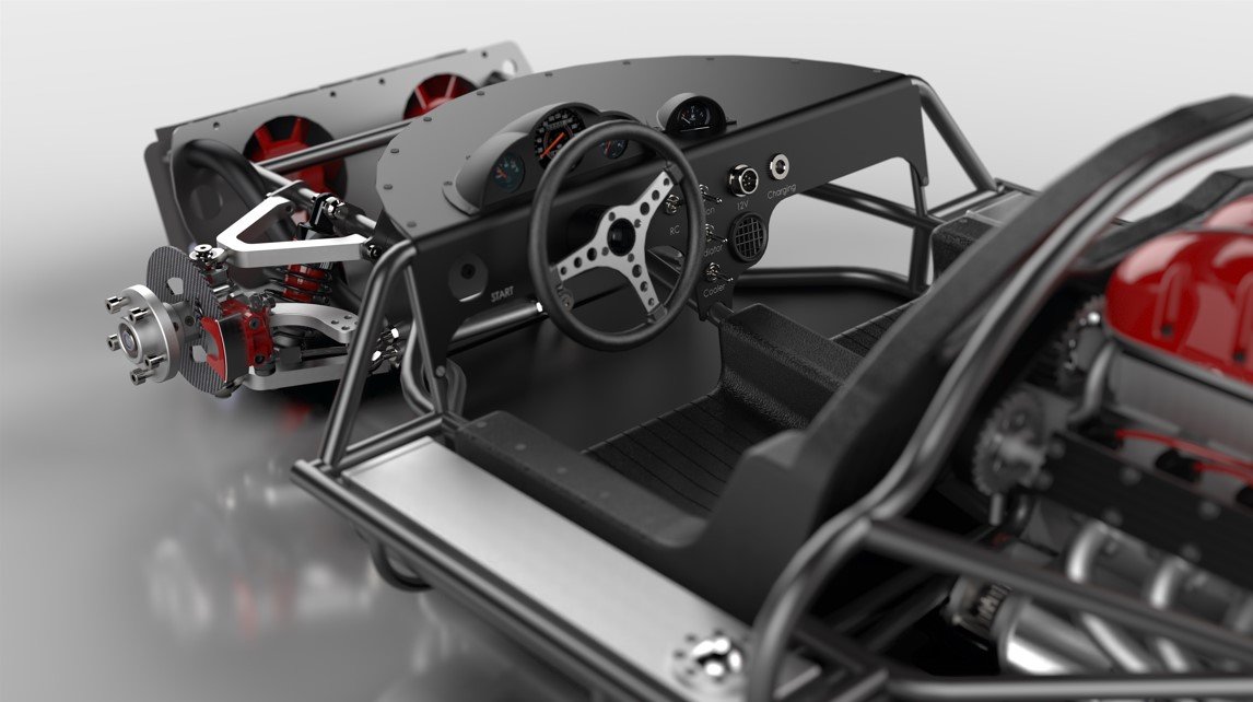

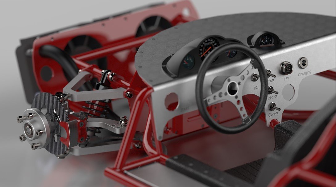

The problem with photorealistic renderings is that it looks like you are finished but you did not even start...

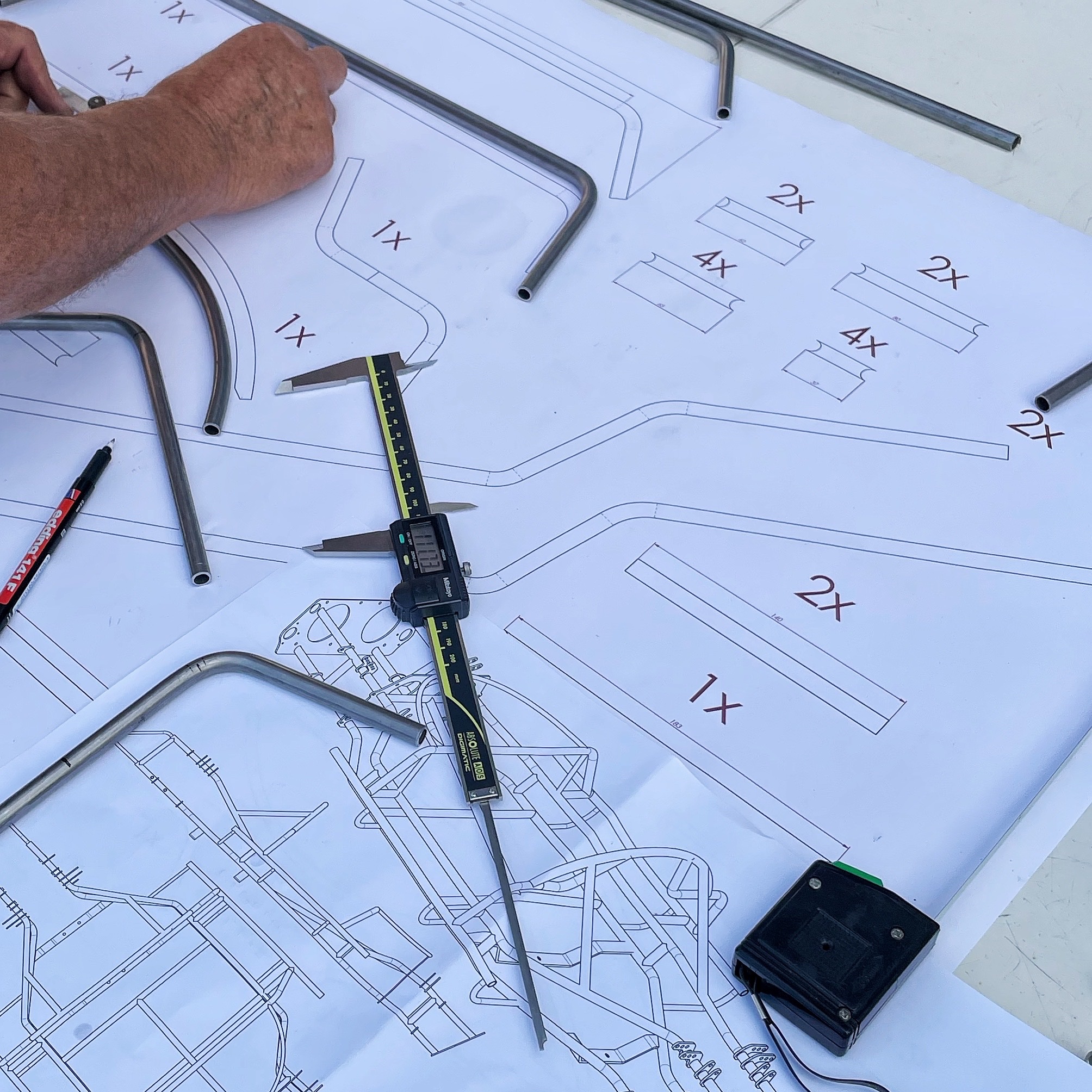

I started to built the tube frame. First of all cutting and bending tubes. Therefore it’s good to have a drawing in 1:1…

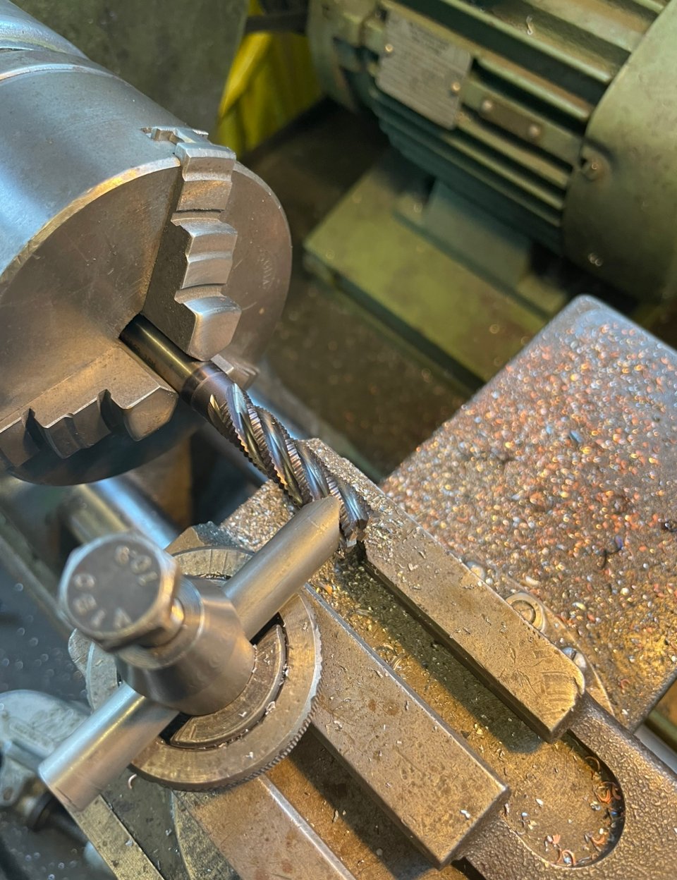

Re: Ferrari 330 P4
I hope so...it is my first complete tube frame. I used my lathe as a milling machine, which came out really good.
